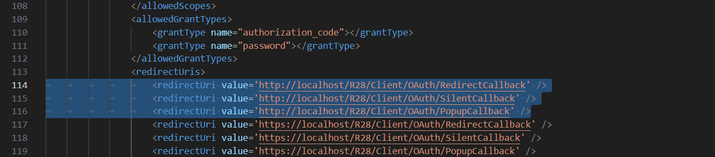

  2. Scroll down until you find the tags for <redirecturis></redirecturis>. Here you will see all the valid connection URLs to access the instance. You will see there are URL defaults for different access points on your machine, such as localhost and IPv4 Addresses. Basically, we will want to add our own URL here as well. Let's say we have changed the name of our PC for the sake of our example, and we want to add a connection to the new name (VM1).
  3. Copy the first 3 default <redirectUri></redirectUri> tags:

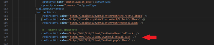

  4. Paste them right below, and we will need to manually change the server names from the URL to the updated machine name, so in this case, we will be replacing "http://localhost/R28" with "http://VM1/R28":

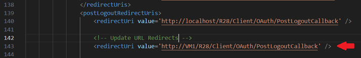

  5. Next, we will update the <postLogoutRedirectUris></postLogoutRedirectUris> tags similarly. Simply by copying the first redirectUri tag and pasting it below the original, changing the server name within the URL from localhost to VM1:

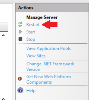

  6. Now all we need to do is open up IIS and click on reset:
