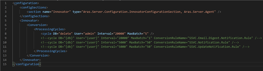

  • Go to the root of your Aras Innovator instance and open up the AgentService and the conversion.config file within it
  • Uncomment the first cycle tag and replace the placeholder values with your Database name, and admin user:
  • After this change it is necessary to open up Control Panel > Administrative Tools > Services and restart the Aras Innovator Agent for your instance.

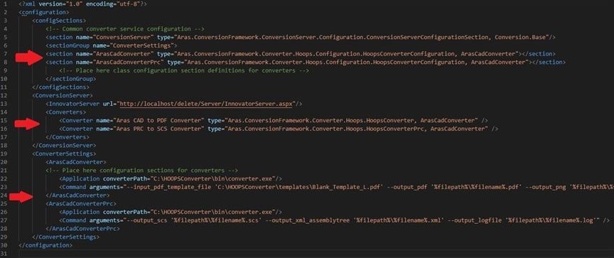

Next we will make changes to our ConversionServerConfig.xml file.
  • Go to the root of your instances Code tree and open the ConversionServerConfig.xml file
  • Within the configSections tag under the sectionGroup ConverterSettings add the following tags:
gist.github.com/.../55274df01f64274d5f04b451a638f1bb
  • Within the Converters tag add the following tags:
gist.github.com/.../6bcde4345b22940073c66973840c5e9f
  • Within the ConverterSettings tags add the following as well:
gist.github.com/.../8db0a08575eac5dbe98f776a85e589c8
  • Make sure however that both the converterPath attributes point to the correct location of the converter.exe. Should look like this with all the new changes:

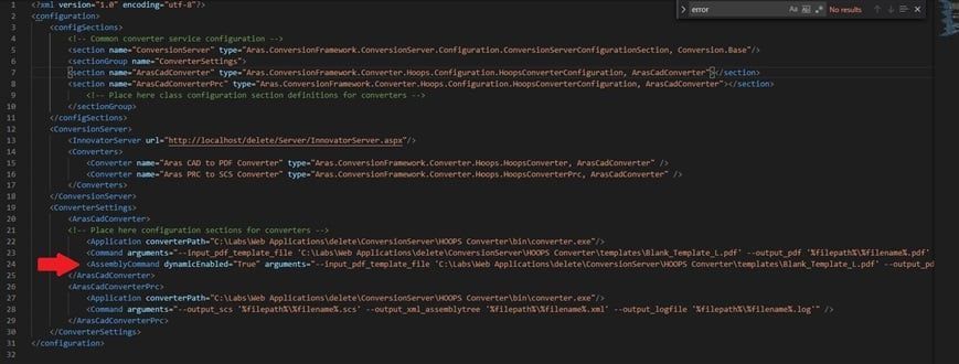

  • We will now need to update the ConversionServerConfig.xml file located in the codetree again.
  • Within the ArasCadConverter tag we need to add the following:
gist.github.com/.../ec2c41ff485e0de493755887993ef7ad
  • Once again be sure to change the value of the input_pdf_template to your instances ConversionServer folder and point it to that Blank_Template_L.pdf file.
  • Your complete ConversionServerConfig.xml file should look like this:

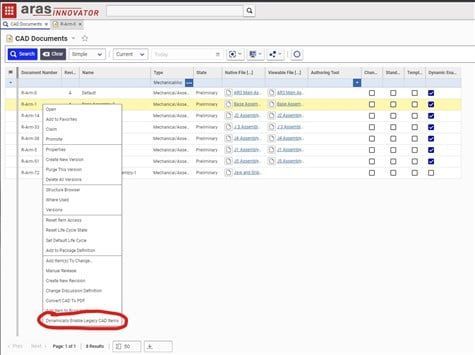

Now that we have configured our instance to run DPN, search your CAD Document Items for an assembly containing CAD files associated to each item. Within the search if you right click on the item you will have the option to "Dynamically enable legacy CAD items", select this action. Please note this action is only required on assemblies which do not have the Dynamic Enabled property flag selected. Assemblies saved/uploaded after the DPN conversion server setup will automatically have the required view files and receive the Dynamically Enabled flag after the conversion completes.

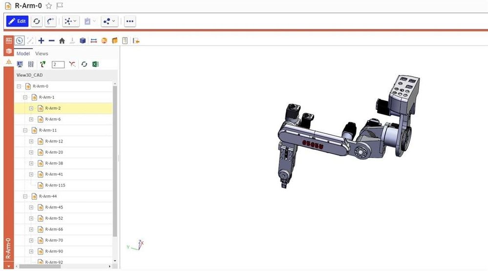

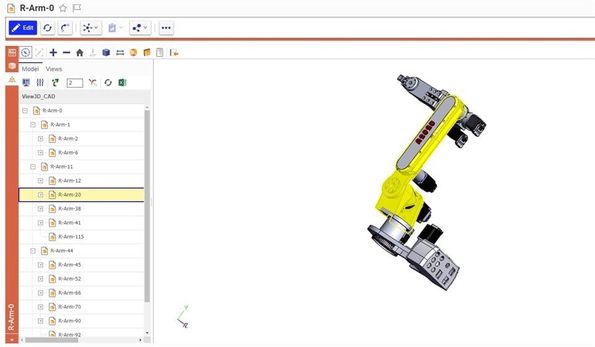

Once it runs you should be able to view your entire assembly and select individual parts to view in it as shown below:
Congratulations you are all setup. Comment on what you think about DPN and how this capability affects your business!
