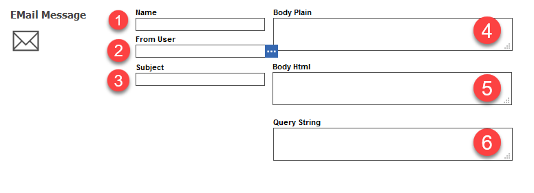

First, let’s set up an email item in Aras. Navigate to TOC > Administration > Notification > EMail Message and create a New Item. Let’s go over what’s on this form real quick:
  • Name: What the Email Item will be named in the database
  • From User: the User account that will send the email.
    • While you can choose any user, if the user does not have an email set, sending will fail and generate a notification in the system log file, if you have logging turned on. General practice is to set this as an Admin account so users know they are receiving a system notification, as opposed to an email from, say, someone in IT.
  • Subject: the subject line of the email
  • Body Plain: if you want to create a plain-text email with no HTML or other enhancements
  • Body HTML: If you want to create an enhanced email

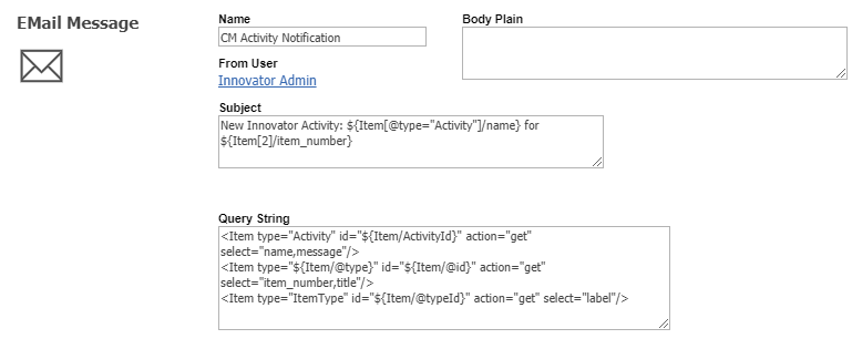

  • Query String: if you want to use XPath and AML to directly query the current item and pull back variables to use in the above items.
You need to Name the item, give it a Subject, and set some relevant Body Text; then save it. That’s it! You have the minimum information needed to add a notification to a flow. This basic email is enough to use, but let’s cover a more advanced setup as well, in the next section.

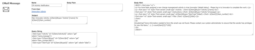

Email Message Form (edited for visibility)
Left Half of Form
Right Half of Form

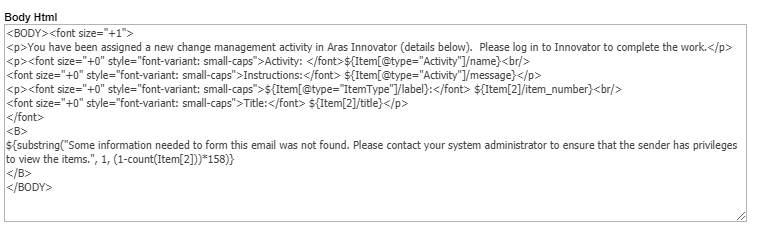

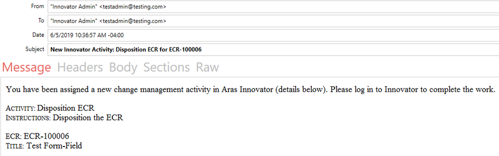

OK, so what are all those odd strings in the above pictures? (I borrowed our OOTB Change Management email.) Those are query strings that pull information from the current context item; which allows your email to dynamically populate with relevant information when generated. The body of the email is also a great place to use these references. You can see in the above example that most of the body text isn’t even coming from the template itself, but from calls back into Aras. As long as you format the calls correctly, the above turns into a nice email like this:
