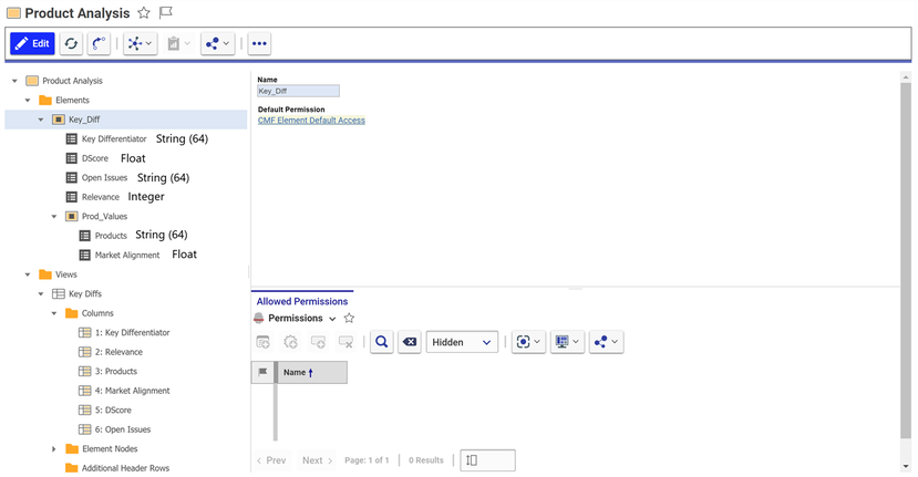

1. We will create the following structure (shown below) with Key_Diff as the root element type and Prod_Values as an element type branching off Key_Diff.
2. Leave out the DScore property type for last.
3. Now we can add the DScore property type by first going to the TOC > Administration > Methods.
4. Then create a new JavaScript method called Compute D-Score (the example code is provided in the Examining the Method section of this blog).
5. Go back to the CMF structure and at the root node (Key_Diff) add another property type:
  • Dscore:
    • Data Type: Float
    • Computed Method: Compute D-Score
    • Dependent Properties: Relevance and Market Alignment
6. Make sure to add the in the views as well with the same names and mapped values all defined as property default.

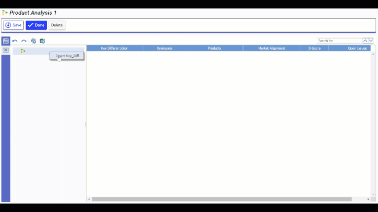

Example
Here we can see our table in action. When we add in our computed values, the relevance, and market alignments on compared products we can see the D-Score value dynamically changing. This is great for the purposes of our use case to distinguish whether our product stands up with the competition.
