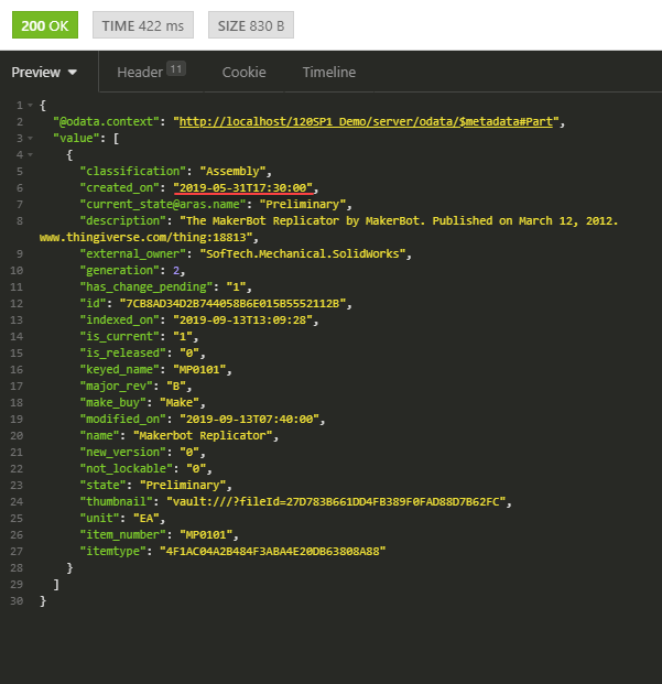

One useful way of utilizing these functions is to filter on date properties. Dates are stored in the database as both a day and time (e.g. 2019-05-31T17:30:00) which can make it impossible to know the exact value. Using the startswith function, we can filter on just a specific day without needing to worry about the time. This would be equivalent to using <created_on condition="like">2019-05-31%</created_on> in AML.
GET {base url}/Part?$filter=startswith(created_on, '2019-05-31')

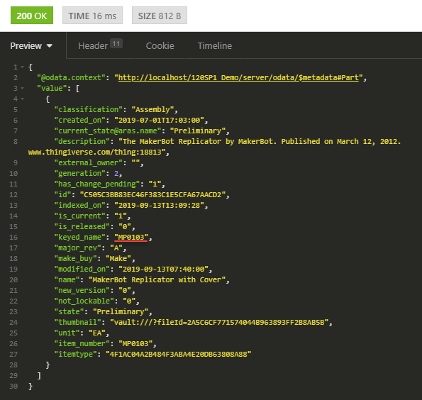

Similarly, we can use the endswith function to perform a wildcard search on the end of a property's value. The query below would be equivalent to <item_number condition="like">%0103</item_number>.
GET {base url}/Part?$filter=endswith(item_number, '0103')

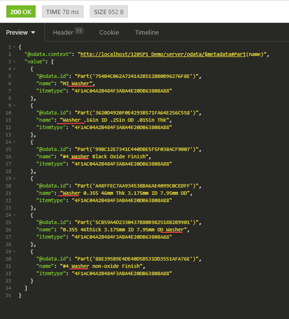

The most general of these functions is contains which checks if the string passed in is anywhere in the property's value. The equivalent here would be <name condition="like">%Washer%</name>.
GET {base url}/Part?$filter=contains(name, 'Washer')

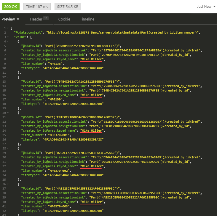

One of the more common use cases when querying for items in Innovator is to query based on some properties of a linked item such as when we want to find all of the items created by a particular user. The query below shows how we can find all of the Parts in the system that were created by a user named Mike Miller.
GET {base url}/Part?$filter=created_by_id/keyed_name eq 'Mike Miller'
The syntax for querying on a linked item is to include the property of the child item after a forward slash ('/'). In this case, we're querying based on the keyed_name of the User item that's linked via the created_by_id property of Part. One of the major benefits of this syntax is that you can continue to query on linked items of other linked items! For example, we could rewrite our query to instead find all of the Parts in the system that were created by any user who had Mike Miller as their manager.
