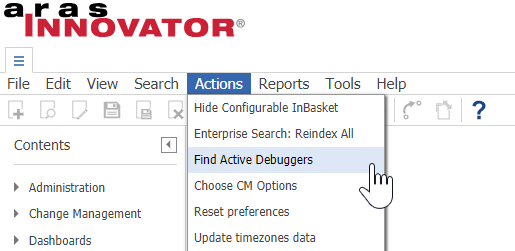

Find Active Debuggers
This project will go through all your methods and look for active debuggers. Running this action before you do any packaging is recommended. Debuggers are one of a developer’s greatest tools, but they should only be included during development.

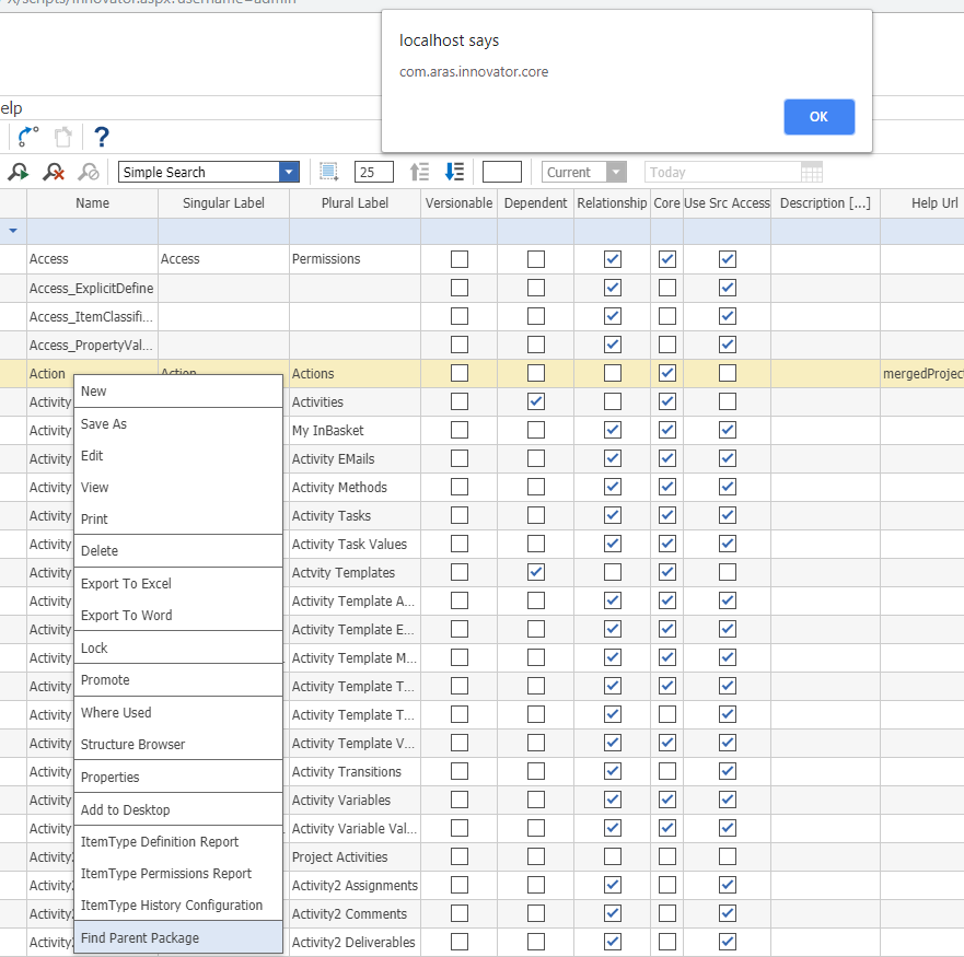

Find Parent Package
Find Parent Package is an item action you can run which will tell you which package the specific item you chose belongs to. This project is very useful for packaging, to verify that any custom development is in the correct package.

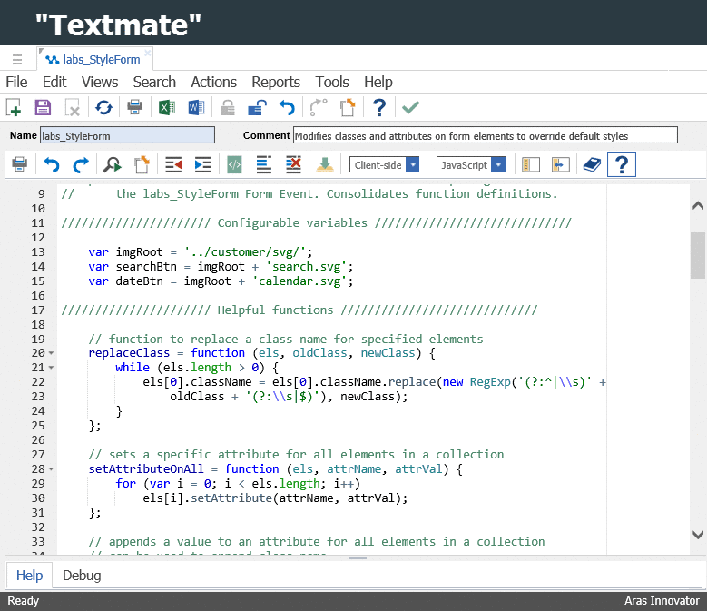

Method Editor Theme Preference
This project allows you to choose between a handful of themes for your method editor. The selection includes dark modes, for developers who would prefer a more classic “night mode” to the standard method editor. Many developers find dark modes easier on the eyes, especially when trying to debug a method for extended periods of time.

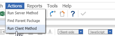

Run Client Method
This action allows you to run your client-side methods from the method editor. There is already an action in place for running your server-side method. This is useful for debugging your client-side methods, however it won’t work with all client-side forms. The context item of a client-side method is much more variable than server-side, and not all of them can be run out of context. This action will also not work with client-side methods which manipulate forms.
Even with its limitations, this action can be incredibly useful when testing your client-side logic.

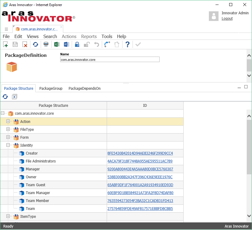

Tree Grid View Sample
This project includes a very simple demonstration of Aras Tree Grid View (TGV) functionality. The import package adds a TGV to the PackageDefinition ItemType and displays the package structure in a relationship tab on every PackageDefinition item. The user can also open individual items that belong to the package directly from the TGV.
Since the sample uses the PackageDefinition ItemType, the project is also incredibly useful for packaging. It allows for you to see all the contents of a package without navigating through each individual ItemType. Using this project to quickly check the contents of your package will help avoid exporting unnecessary items.
