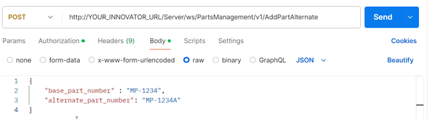

With Postman open, we can set up the sample call we will be using to test our new Method endpoint. If you’ve been following along, your request should look something like the screenshot below. Note that because this is a Method endpoint, the request type should always be POST.
After configuring the Authorization for the request (either using an API Key or authenticating via OAuth), we should be able to click send and see that our Part Alternate was successfully added!
