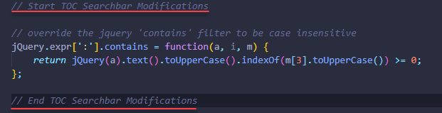

  • Mark whatever changes are made inline in the file
    • For each section of code we add or modify, we should include a comment before and after it to point out what pieces have been changed.

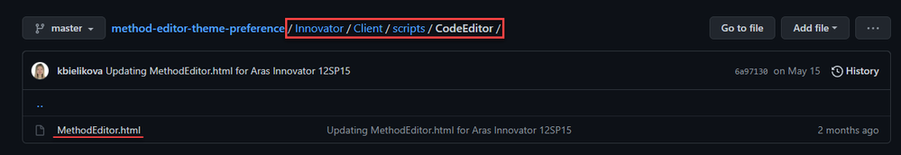

Once we've finished making and testing our changes, we will need to package up these changes so we can move them to our QA or Production instance. The end goal of this package is to create a folder that contains all of the files we changed, in the relative locations within the codetree that they usually are. We can then simply copy the top-level folder of our pacakge and paste it on top of another instance in order to apply the change. To accomplish this, we will want to create a new /Innovator/ folder that will hold the relative paths to each of the files that we have changed.
We can see an example of this in the Method Editor Theme Preference community project. This community project adds an option for developers to change the theme they want to use for the standard Method Editor. To accomplish this, we needed to modify a file in the codetree that controls how the Method Editor gets loaded, and if we look at the files included in the community project, we'll see that it includes a relative path down to the /Innovator/Client/scripts/CodeEditor/MethodEditor.html file.
