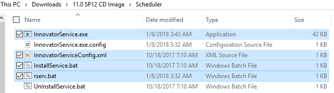

The service can be installed from your Innovator CD image in the Scheduler folder using the below instructions:
  1. Copy the files listed below (or see the above image) into a separate folder on your hard drive (Ex: C:Aras_Scheduler) to access them outside of the CD image.
    1. InnovatorService.exe
    2. InstallService BAT
    3. rserv BAT
    4. InnovatorServiceConfig.xml
