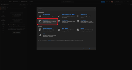

Before we get to the fun stuff we will need to authenticate our requests. Go ahead and open up Postman then create a new Collection workspace.

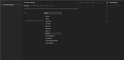

- Click on the Authentication tab on the workspace
- In the dropdown select OAuth 2.0

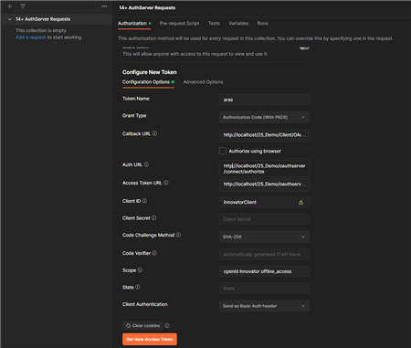

- Set the Configuration Options to the following:
- Specifically ensure the following fields are input correctly. Use the following values for the Callback URL, Auth URL, Access Token URL, and Scope
- Callback URL: http://<servername>/<web alias>/Client/OAuth/PopupCallback
- Auth URL: http://<servername>/<web alias>/oauthserver/connect/authorize
- Access Token URL: http://<servername>/<web alias>/oauthserver/connect/token
- Scope: openid Innovator offline_access
- Once you have filled all of those values in, click the Get New Access Token button at the bottom left and log into the popup Aras Innovator window with your credentials
- If you log in correctly you will get another popup window with the access token. Within this window click Use Token.

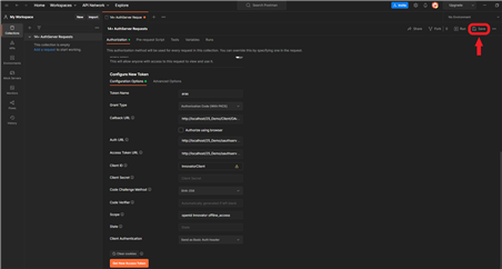

- Now be sure to hit the Save button on the top right corner before proceeding to any next steps

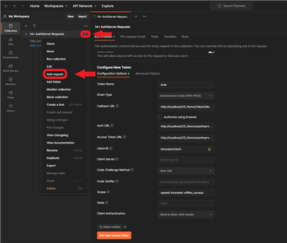

- Right click on the Meatballs Menu on the left hand side on your 14+ AuthServer Requests workspace and select Add Request

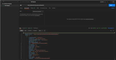

- Make sure the request is a GET then in the Enter request URL field input the following URL: http://<servername>/<web alias>/Server/Odata/Part
- Go ahead and hit Send to run the request
- You should start seeing the return JSON with all the parts within your database:
If you are seeing the following screen you have successfully gotten data back from the server!
