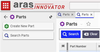

When opening Aras Innovator 12 for the first time, you will need to click on the large red button in the upper left to open the table of contents (TOC). You can now pin the TOC open or hide it to save screen space.
The other major change to the TOC is that each option is now a series of pages or leaves. If you want to go straight to your selection’s search page, click the icon to the right of the name. If you want to see what options are available for the item (including creating a new item), click on the item name itself. Direct dashboard entries that have no leaves have an open icon next to them to show they directly open a page in a new tab. This replaces the ability to have category forms in v11 and will be expanded upon in future releases to make the TOC more customizable.

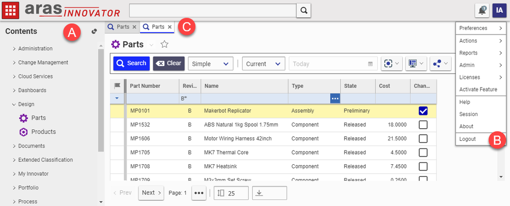

The main menu bar from v11 has been reorganized into a new user menu that can be accessed by clicking on the in the upper-right. This icon will either be the user's initials or their picture if one has been entered. The categories are as follows:
The other two major navigational changes are regarding tabs. First, the entire Aras Innovator instance now runs in its own browser tab! No more opening a pop-up window. Second, you can now have multiple searches, instances of an item, or even inbaskets open at the same time.

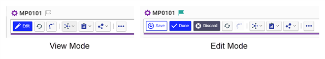

When interacting with an item in v12 there are now visually distinct view and edit modes. There is also the claim/unclaim flag, we'll explain all this below:
Once in editing mode, the user can do one of three things:

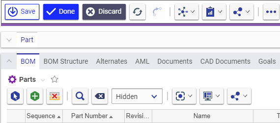

The toolbar for editing the relationship grid has been altered with more dedicated icons and fewer menus. Also, the tabs on/off settings have been replaced with an accordion option to show/hide the two main sections of the screen. The new buttons are as follows:
One further thing to note concerning the relationship grid: the ability to edit entries is tied to the edit status of the parent item. If the parent item is in view mode, related items can only be claimed for future editing. If the parent item is in edit mode, the related items may be edited via the context (r-click) menu. There are options to edit, done editing, and discard changes, similar to the main item toolbar.
B. User Menu
- Preferences: This covers certain optional settings such as wildcards, updating your password and e-signature, and toggling the visual collaboration panel.
- Actions: Global actions, such as resetting timezone data, reside here.
- Reports: Reports that have a global scope reside here.
- Admin: The API references have been moved here, as well as some admin actions, like rebuilding keyed names, that were under the v11 tools menu.
- Licenses: The licensing menus have been moved out of admin and to their own menu in v12.
- Activate Feature: This is a direct link to the input license key dialog.
- Help: This link will now take you straight to Just Ask Innovator.
- Session: This will pop up a window with your login name, database name, and server address.
- About: The about page with copyright, software version, and build number info.
C. Tab Updates

Claiming and Editing
View Mode
- The claim/unclaim flag shows if an item has been claimed for editing. This does not activate edit mode, just stakes a claim until removed.
- If you are coming from a previous version of Aras Innovator, claiming replaces the concept of locking and unlocking an item.
- The edit button toggles between view mode and edit mode. If an item is unclaimed, pressing edit will also claim it, if available. The edit mode buttons are discussed below.
Edit Mode
- save the item, with the claim remaining open.
- save and unclaim the item by pressing Done (This is the Save/Unlock portion of the old Save/Unlock/Close option in v11.)
- or, discard their changes to the item, unclaiming it. (This option was available in v11 on unlocking, but has been brought forward to the menu to be more visible.)

Pick/Create Item & Relationships Grid
- The icon is Pick [Existing Item], this is the same as the Pick option in the old v11 dropdown menu. This option is used to create a relationship to an existing item.
- If you need to Replace a related item of an existing relationship, right-click on the row and select the Replace option.
- An example of this usage would be adding a component part to an assembly part's BOM. The part you are adding to the relationship should already be pre-existing.
- The icon is Create [New Item], this is, again, the same as the Create option in v11. This option is used to create an entirely new related item on the fly. After pressing the button the user will fill in the properties of the new item in the grid. Saving the current parent item will then save the new related item.
- A usage example here would be adding a line to a purchase order. You've never needed to buy staplers before and now need to add an entry to the system for the current request.
- The icon is to Delete a relationship. This does not affect the related item.
- Also, for those familiar with xProperties and Redline View, those options are now available directly on the relationship toolbar with the and respectively.
- The Share icon is where the export functions live, as in the main item toolbar.
