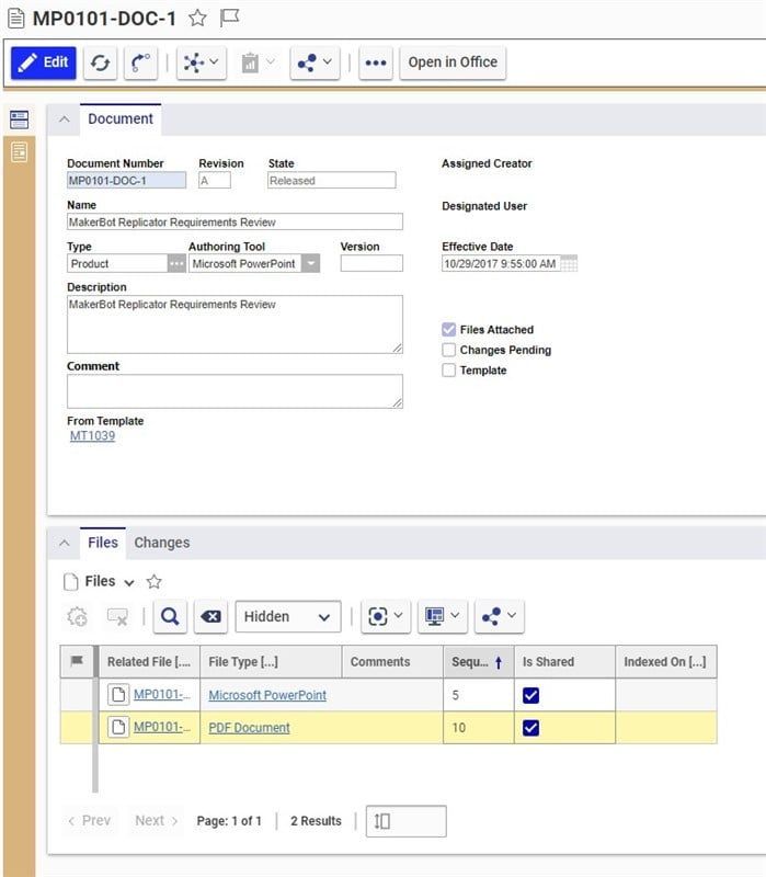

With that out of the way, let’s get started with doing things in Aras Innovator. First, we want to upload a file, so we can sort or download it later. The basic container is the Document, so follow the following steps:
  1. Open the Table of Contents, then go to Documents->Documents.
  2. Create a new Document item.
  3. Give the Document a name.
  4. Click Save.
  5. Click the Relationship tab below, then click Create Item.
  6. You’ll be prompted to select a file from your local computer. Do so.
  7. Back in Aras Innovator, click Save.
  8. Click Done.
There you go, one container (the Document Item) with its respective File Item. As with many things in Aras Innovator there’s more than one way to do this- we just made a relationship to a File item, but we can have an Item property that’s a File item instead if we prefer. The default CAD Document ItemType does this, and it’s a perfectly serviceable way to do things.
Downloading is much simpler. In many places where you see the file referenced, it will appear as a hyperlink- blue text with an underline. Simply left clicking on it, for instance in the Files relationship tab, will start either a download or a new window in your browser showing the contents of the file. It’s that easy!
