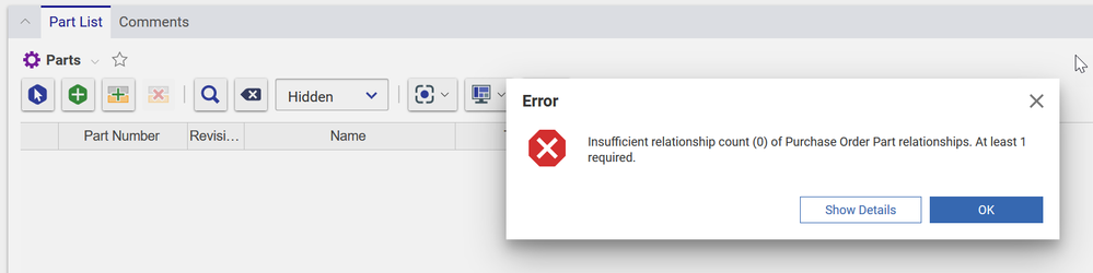

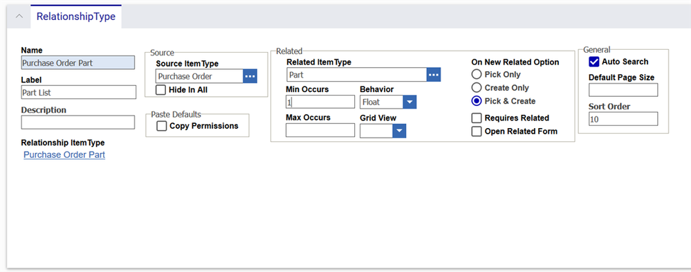

Let’s open up the Purchase Order Part RelationshipType for editing (not the ItemType!), which can be found under Administration > RelationshipTypes > Search RelationshipTypes. When a new Purchase Order is created, we want at least one Part to be attached to it before it can be saved. To ensure that this happens, we’ll set the Minimum Occurrences (in the Related group box) to 1. Now, save and unlock the Item and we’re done! We can test this out by creating a new Purchase Order and trying to save the Item without adding a related Part; an error dialog will be shown to us indicating what the problem is.
This method also works if we want to set a maximum number of entries of a RelationshipType, just enter the maximum value in the Max Occurs field. Both occurrence checks can be used simultaneously, just be sure that the minimum is less than the maximum. Additionally, if we wanted to remove any occurrence checks, we would leave the field blank (rather than enter in a value of 0).

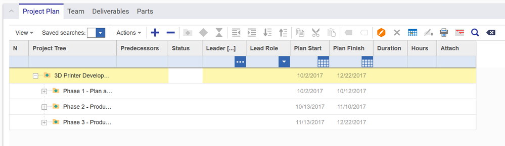

Sometimes, when we have a Relationship, the standard grid layout isn’t the best way to show the information for that Relationship. Or possibly we want to have different Views depending on what User is looking at the parent Item. Building a custom view from the ground up is beyond the scope of this blog, so we’ll use two existing RelationshipTypes as examples: Project Tree on the Project ItemType and Part Multilevel BOM on the Part ItemType. Let’s take a look at the Project Tree RelationshipType first.

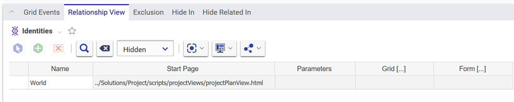

The Project Tree’s Relationship View is set for the World Identity, so all users will see the Relationship View. The Start Page value is set to an HTML file so when the Project Plan Tab is opened, a custom HTML page is loaded instead of the standard relationship grid, as shown below.

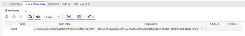

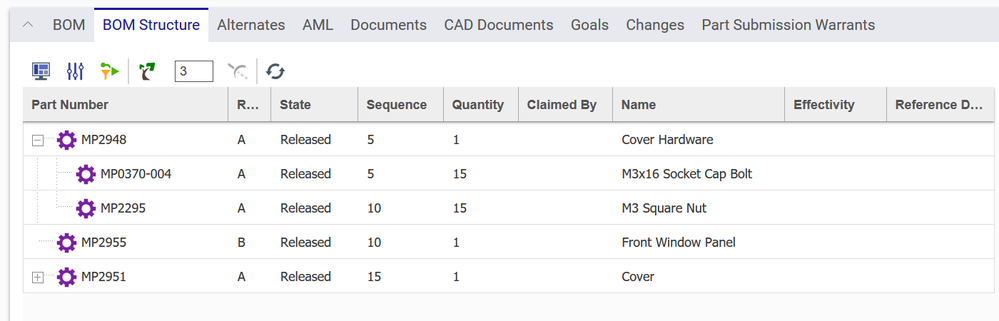

The Relationship View for Part Multilevel BOM has the Start Page pointing to the Tree Grid View main page. In order for this page to display the Part Item’s data correctly, we also need to pass in Parameters such as the ID of the Tree Grid View and a start condition with the source ID of the Part Item. When we open the BOM Structure Tab on a Part that’s an Assembly, we can see the entire bill of materials in an expandable list.
