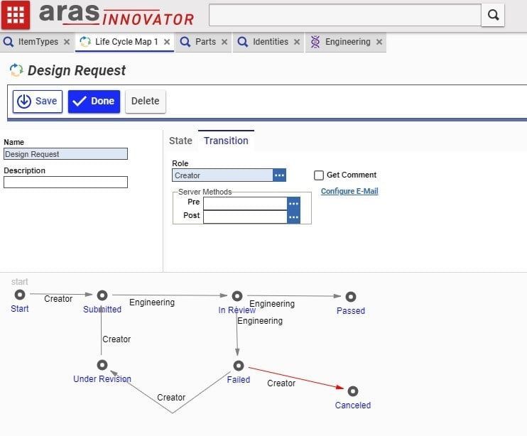

  1. In the Table of Contents (TOC) navigate to Administration -> Life Cycle Maps and click “Create New.”
  2. Make sure you give your new Life Cycle Map a name. Here, we’re calling ours “Design Request.”

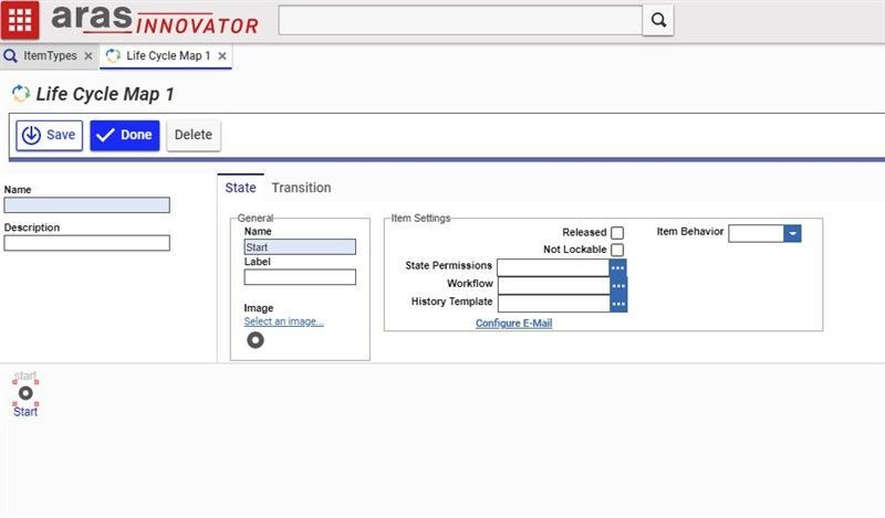

  3. Below, you should see a map on which you can add states and transitions. Right click on an empty space to add a state.
    1. You can edit the name of that state by left clicking on it, then changing the State Name on the form above.
    2. Remember, you can drag states around by left clicking and holding on a state, then dragging your mouse where you want the state to be.
  4. Once you have a few states, add transitions between those states by right clicking on state and selecting “Add Transition” then left clicking the state you want to connect it to.
    1. You can change who can use a transition by left clicking on it, then editing the Role field in the form above.
    2. You can also add bends to a transition line by right clicking it and selecting “Add Break.” This won’t affect the function of the transition, but it can help make things visually cleaner.
  5. When you’re ready, click Done  to save your Life Cycle map.
