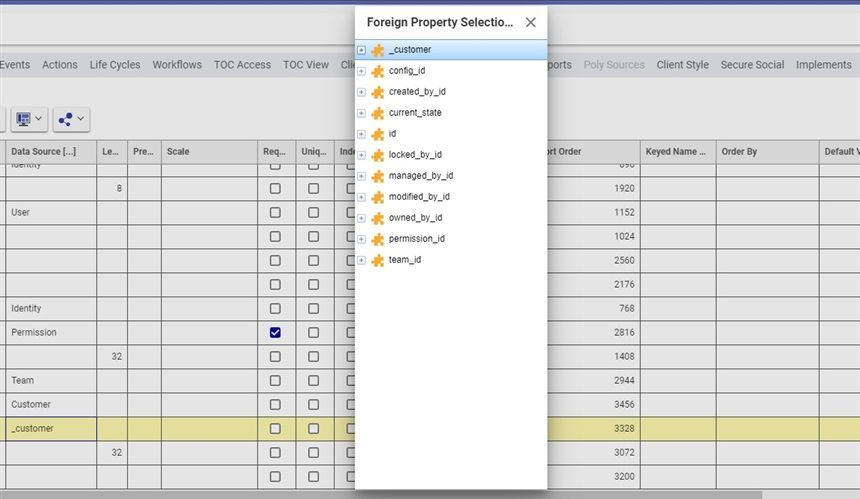

  1. From the Properties tab of the Purchase Order ItemType, click the Add Row button.
  2. First, we need the basics for a property. Enter “_customer_address” for the name, and “Customer Address” for the label. We need the name for the system, and the label so it’s clear to users what this represents.
  3. Select “Foreign” for the Data Type.
  4. Click on Data Source. In the dialogue, look for _customer, and click the expand icon.
  5. Double-click on Address.
  6. Click Save.
If you look at the Foreign Property value of _customer_address, you’ll see it just says “address.” While it gets set by what you use for Data Source, this is a quick way to look at what property of that other item your new property is using as a reference.

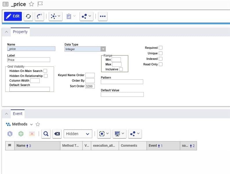

A Default Search can be used to set up, in advance, a search that a user can run as soon as they open up an item for searching. While the user can override this search, it’s useful if there’s one main search that you know most users will go into that ItemType looking for. For example, perhaps you want your users to prioritize purchase orders with prices above a certain threshold; in that case one could arrange for Purchase Orders to default to searching for things with a price above 100.
  1. From the Properties tab of the Purchase Order ItemType, look for the _price property.
  2. In the Default Search column, type “>100” to specify that the search should return only things with a price above 100.
  3. Click save.
Now, if you find Purchase Orders in the table of contents and open a new search, you should see that there’s already some criteria in the Price column. This can be combined with Autosearch for very convenient searching, or simply used to pre-fill some suggested searches. Unfortunately, searching for "the best item" doesn't turn up results in most environments. Next update maybe!
Property Events
Properties can have methods tied to them, triggering when certain events take place. This allows you to build up complex functionality from the methods you have available, and even simple methods can be exceptionally convenient. To set up a property event, follow the following steps:
  1. From the Properties tab of the Purchase Order ItemType, right click on the property you’d like to make an event for.
  2. From the menu that results, click Properties, and then click Open. A new tab will open for that specific property.
  3. Below, you should see the Event tab. You’ll need to click Edit to open up the property for changes, but once you’ve done that you can click the select icon  to see a dialogue where you can search for the method you want. Select it, then click OK.
