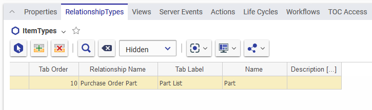

  3. Navigate to the RelationshipTypes tab (next to the Properties tab).
  4. Click on the ‘Select Item’ button  to define a new RelationshipType. In the search dialog, search for and select the ‘Part’ ItemType by its name.
  5. Fill out the table row for the new RelationshipType.
  6. Start by specifying the tab order, we’ll put 10 – though this only matters if we have more than one Relationship.
  7. In the Name column, enter ‘Purchase Order Part’.
    • A typical naming convention for RelationshipTypes is to use the source and related ItemTypes’ names.
  8. Enter 'Part List' in the Tab Label field.
    • This will be the name of the tab that the user sees when editing the source item.
  9. Save and Unclaim the Purchase Order ItemType by clicking on ‘Done’.

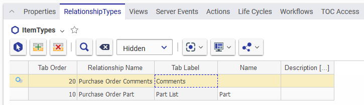

  1. While editing the ItemType, navigate to the RelationshipType tab.
  2. Click on the ‘Add Row’ button to get a new blank row. Note that the far-left column has the ‘Null Relationship’ icon.
  3. Fill out the table row.
  4. Start by specifying the tab order as 20.
    • This will make the Comments tab come after the Part List tab.
  5. Enter ‘Purchase Order Comments’ as the name for the RelationshipType.
    • A good naming convention is to use the source ItemType’s name and a descriptive name of the new Relationship.
  6. Enter the Tab Label, we’ll set this to ‘Comments’.
  7. The name column stays blank for a Null Relationship.
  8. Save and Unclaim the ItemType by clicking ‘Done’.

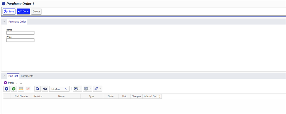

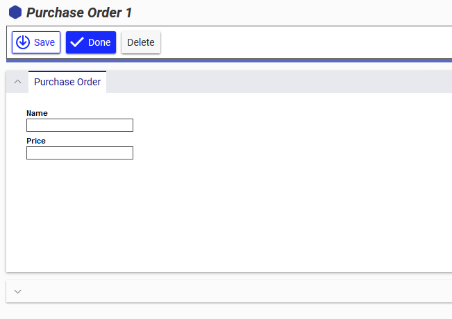

Let’s test out our new RelationshipType by opening a Purchase Order for edit. And … hm, we can’t see the Relationship tabs.
Oh, of course, we forgot to enable the view for the Purchase Order ItemType.  That’s an easy fix; we just need to enable the source ItemType to show Relationship tabs when an Item is opened. To do this, we’ll open the Purchase Order ItemType for editing, click on the Default Structure View drop down menu and select ‘Tabs On’.  We can then save the changes. Here’s a list of the Structure View options and what they mean:
  • ‘Tabs On’ will display all relationship tabs if there are any associated with the ItemType.
  • ‘Tabs Off’ is the Aras Innovator default and hides the Relationship tabs from the accordion section of the Item.
  • ‘Tabs Min’ adds the relationship tabs to the accordion section but defaults it to closed.
  • ‘Tabs Max’ is currently the same as ‘Tabs On’ but may change functionality in the future.
Now that we can see the Relationships for this ItemType, we can test the new RelationshipTypes by adding them to a Purchase Order Item.
  1. Open a Purchase Order Item for editing.
  2. Add a Part Relationship Item by clicking on the ‘Parts List’ tab.
    • I have a premade Part to use, so we’ll click the ‘Select Items’ button and search for the Part, highlight it by clicking on it, and hit ‘OK’ to add the Relationship.
    • If you're following along and don't have a premade Part, you can click the 'Create Item' button  to add a new Part on the fly.
  3. Add a Null Relationship Item by clicking on the ‘Comments’ tab.
    • Click on ‘Add Row’  and fill out the values with our comment.
  4. We’re done adding Relationships to this Item, so we can Save and Unclaim the Purchase Order by clicking 'Done'.
