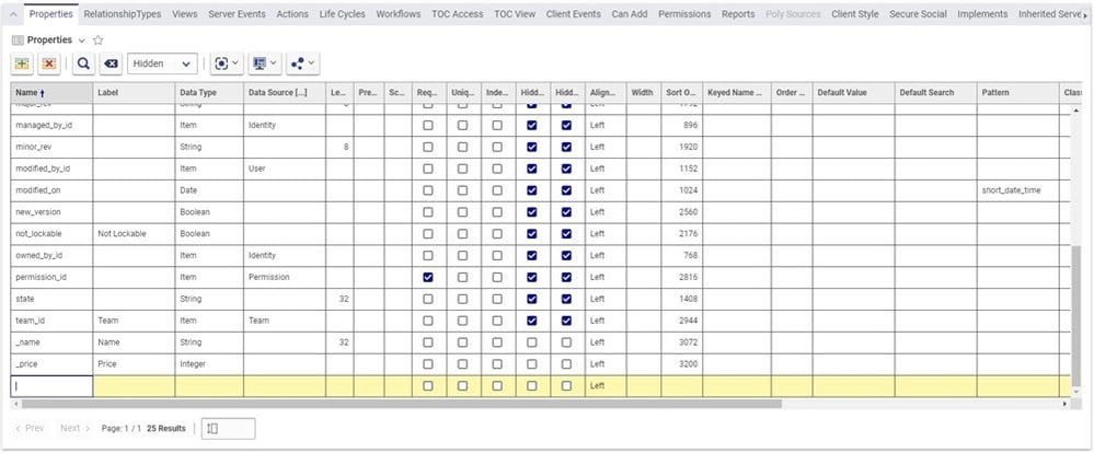

  1. Click the Edit button  and in the Properties tab.
  2. click the Add Row button at the top left of the tab.
  3. A new row appears, and we can enter information for our new property.
 Each new property we add, we’ll come back here and click the Add Row button.
