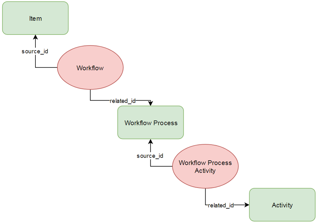

1. Use the Relationship Structure
One of the most common scenarios in Aras method code is to retrieve data from the parent or child items in a specific item's relationship structure. For this example we will assume that we know an Activity item's id and we need to find the related Workflow via the Activity's parent Workflow Process.
Incorrect
One approach to finding the Workflow is to first query for the Activity's related Workflow Process, then use the result to query for Workflows with an id matching the Workflow Process' related_id. While the two-step approach shown below certainly works, it is not the best way to get the parent item because it queries the server twice to retrieve a single item.
gist.github.com/.../f0c770113ccb3237c69fb4e83c43601f
Best Practice
The best way to retrieve data from related or parent items is to use the relationship structure to build a single query. The sample code below shows how to build the relationship structure that connects the Activity item to the Workflow we want to retrieve.
gist.github.com/.../e60ee0bff052d1a3902aba33c7e5d466
