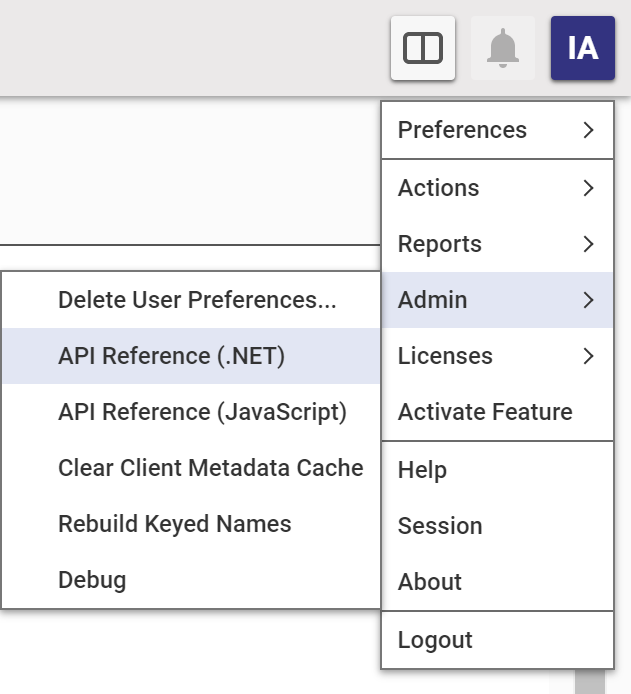

Apart from the added peace of mind of knowing that your code can be easily ported to a newer version, there's an even better reason to use the Innovator API wherever you can. It's already written! The best code is no code after all, so if we can save the time of needing to write our own functionality, we should. You can take a look at the Innovator API and the objects and functions within it by logging into your instance as an admin and selecting Admin > API Reference (.NET).
