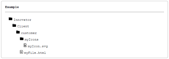

If you do need to include custom code tree files, such as an external HTML file or a folder of icons, it's best practice to place the files under the InnovatorClientcustomer directory. This keeps custom files organized in one place and helps prevent them from being overwritten or lost during upgrades.
Files in the InnovatorClientcustomer folder can be accessed via relative path, or via direct path such as http://localhost/innovatorserver/Client/customer/myFile.html or http://localhost/innovatorserver/Client/customer/myIcons/myIcon.svg.

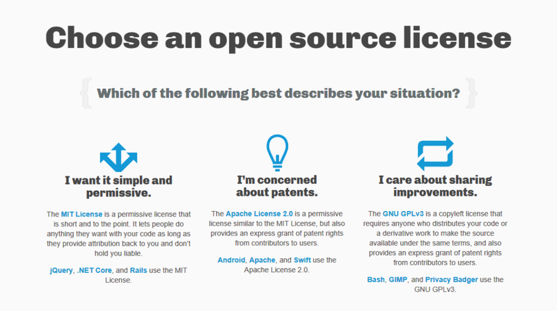

Do: Include a License
Visit https://choosealicense.com/ to try out GitHub's tool for choosing an open source license for your project.
Tell community members how they are allowed to use your code by including a license with your Aras Community Project. All Community Projects created by Aras Labs are published under the MIT license. If you are unsure which open source license is right for your project, check out ChooseALicense.com, a handy tool created by GitHub to explain the various open source licenses.
