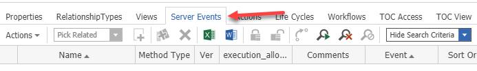

Server (or Client, but that’s a different blog post) Events are methods that are triggered by a particular system action, whether that is a Get, Edit, Save, et cetera. Setting another method on these events will extend or override the existing system functions. Events can be set at the Itemtype, Lifecycle, Workflow, and other levels. For the purposes of this blog post, we are going to work with Itemtype Events. You can add a Server Event from the tab of that name from the Itemtype’s definition.
