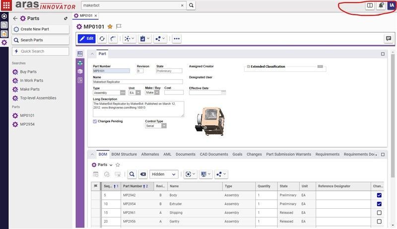

Headers
Lets start from the top. The main window header bar is the top of most Aras Innovator displays, always available and omnipresent. Tweaks to the header allow you to place buttons that are available anywhere in your Aras Innovator instance, and are best used for new actions that aren’t dependent on where you are. An in-depth overview of how to use CUI with headers can be found here. The location name for this is the MainWindowHeader.

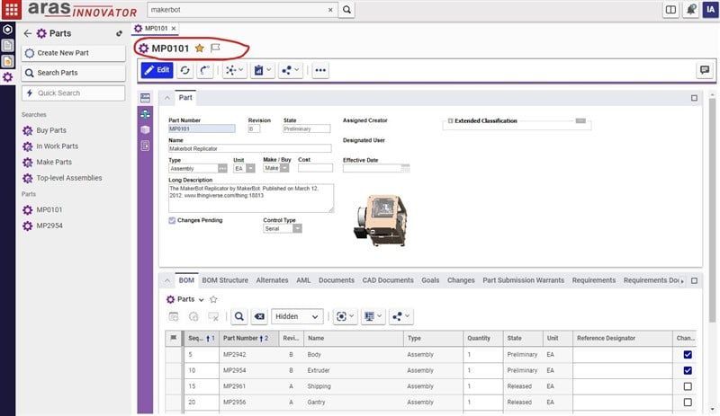

Title Bars
Just below the header in visual prominence is the title bar. Placed under tabs, above the focus of most screens, the title bar is context dependent but easy to find. You should use title bar changes for things you expect your users to need often, but not tied to a specific item. While this area has a lot of visual space, it’s easy to make it crowded. This location is the SearchView.TitleBar.
Generally, buttons here do something to what’s beneath them like claiming an item for use for use, or showing the itemtype description for the itemtype you’re searching on. We recommend keeping to that design language: this is a place for actions, specifically actions that relate to what’s beneath the title bar.

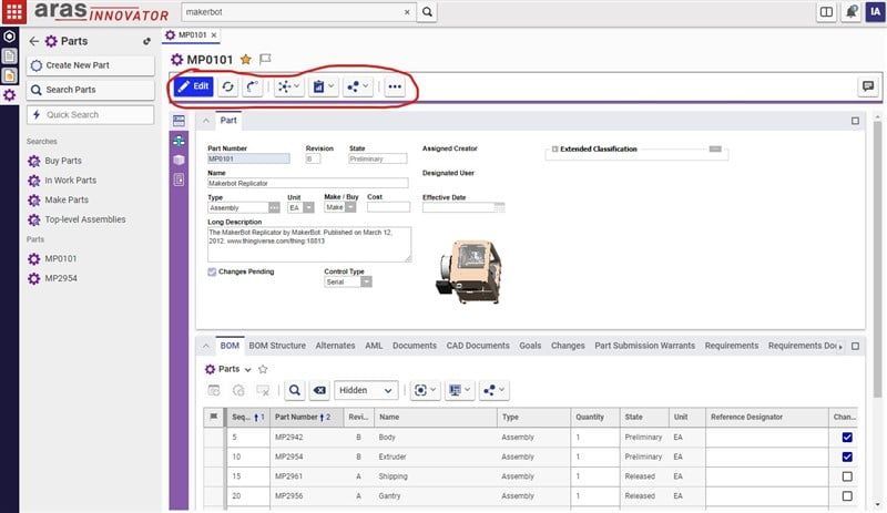

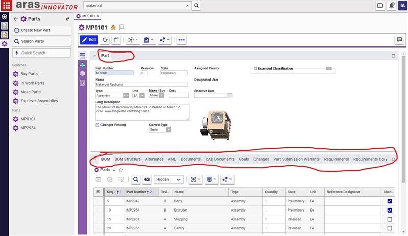

Now we get to the options that are only available when you have an item open. The item views show forms or grids full of information that pertain to one item. Here, you can add tabs to the top or bottom sections, or even add a third segment to the item view. There are many locations applicable here, each starting with ItemView. and continuing with the specific example, such as ItemView.RelationshipsCommandBar
The usual design pattern that Aras follows is to have the item form itself visible at the top (and if you want to change the item form, we have another article for that! It's here) and to have relationships in the bottom segment, with each relationship having its own tab. That isn’t a design pattern that you have to stay with however. If there’s a specific relationship that you feel deserves to be broken out into its own segment, this can allow a user to compare information from two places much easier. We do recommend not using too many segments since it requires a user to scroll up and down between them. Two segments is about as many as most users will be able to see simultaneously, though they can minimize and expand segments at a click.
Toolbars
Toolbars are often seen on relationship views, giving options for interacting with what you see. Some change individual relationships, while others act on all the options you see. Of course, Aras Innovator prides itself on being configurable, so you can add buttons that do all sorts of things here, but it’s best to remember what information is close at hand. Nothing stops you from adding interactions to affect the item itself, but it would be unintuitive. For a closer look at how CUI and toolbars work, take a look at our article here. Like ItemViews, toolbars have many formal locations. You can see most of them by searching "*toolbar*" in any locations search.
Toolbars aren’t only seen here of course, and the same approach will work wherever you need to add the toolbar. At its heart, a toolbar is a like a toolbelt, an array of tools for you to make use of. They’re kept close together just like your hammer and your wrench are often close at hand. Make use of separators to keep categories of tools distinct.

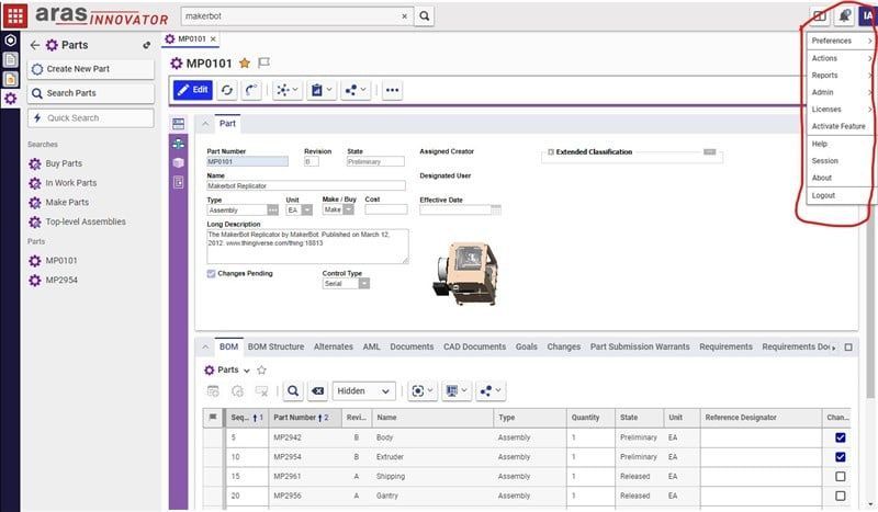

Menus
There are lots of menus in Aras Innovator. From search grids to navigation to the big user menu at the top right, the ability to alter menus means the ability to add or gate a lot of capability. It’s hard to give general advice for menus, because they come in so many varieties. Fortunately, menus are where you can give the most detail and description: a menu doesn’t need to be an icon, but can be written words. Further, menu options show up alongside each other, meaning they can give each other context as well as be informed by where the menu shows up. After all, if you right click an item from a search grid, “open” and “promote” obviously refer to the item you clicked on, and a user would similarly understand “share” would work the same way. You can read more about CUI and menus here, and we encourage you to do so: menus are one of the more common places to add functionality to Aras Innovator.
