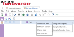

The first thing you'll see in the editor is the root element of our query on the right and several icons on the left. To begin with, we'll add some additional items to our query by right-clicking on the root element.

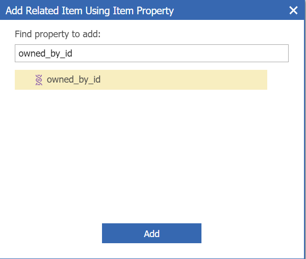

We want to get the Identity that owns this part. This information is stored in the owned_by_id property of the Part ItemType which we can add to the query by selecting Add Related Item > Using Item Property... . In the resulting dialog, we can search for owned_by_id, select it, and click Add.

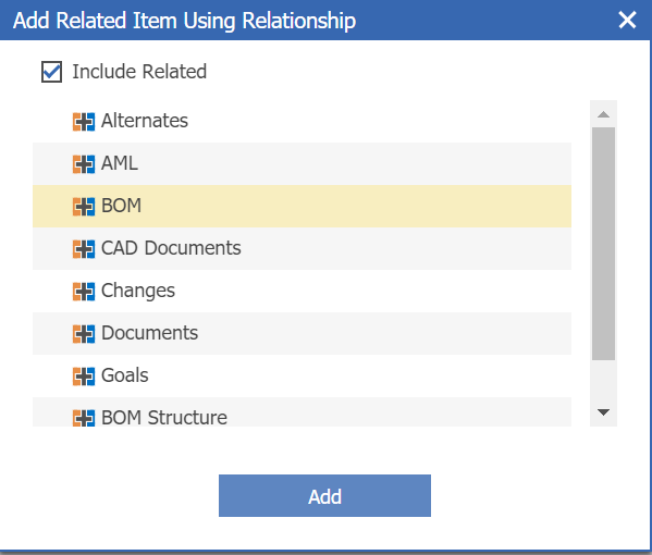

Now that we have the owner, we want to go ahead and also get any child parts as part of this query. We can do this by selecting Add Related Item > Using Relationship... and selecting BOM. We want to make sure that Include Related box is checked, so that we'll also add the related Part to the query and not just the Part BOM relationship item.

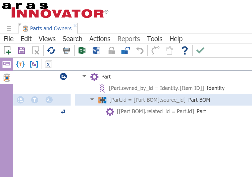

Great! We can see now that we'll also get any child parts with this query. However, this doesn't account for the situation where a child part has children itself. Fortunately, Query Builder allows us to easily define a recursive query for just such a situation. We can do this by right-clicking on the recently added child part and selecting Reuse Query Element Definition. Pick the top-level Part in the resulting dialog. After running this, your query should look something like the screenshot below.

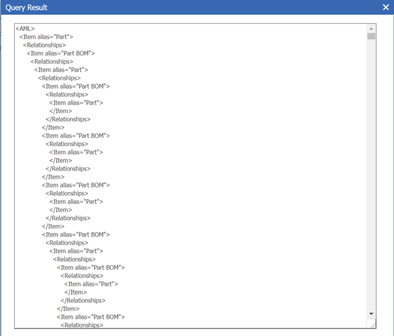

Now that we seem to have our query in place, we can execute it to make sure that the results are what we expect. To do this, we can run the Execute Query action from the Actions menu. This action will bring up a dialog that will let you pass any additional parameters into the query such as a specific id or item_number. For this example, we'll just click the blue Execute button at the bottom. Your results should be something like below.

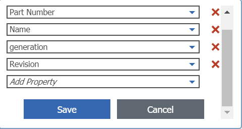

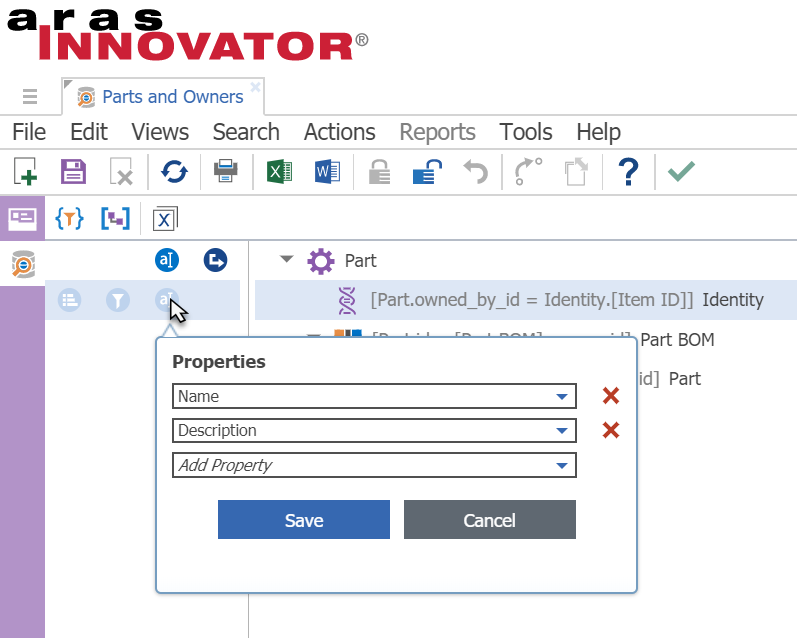

That's not quite right. We're getting the items we expect, but there's no additional information about them. This is because we haven't selected any properties to be returned. If we right-click on the top-level Part element of the query, we can select Edit Query Element > Selected Properties... we can choose the properties that should be returned similar to editing the select attribute of an AML query. In this example, we're going to choose Part Number, Name, Generation, and Revision.
Notice that any properties we select for the top level Part are also applied to the child because it's reusing the query definition. We're also going to select some properties for the Owner Identity. Let's do this a little differently and instead click on the Properties icon to bring up the selection dialog.

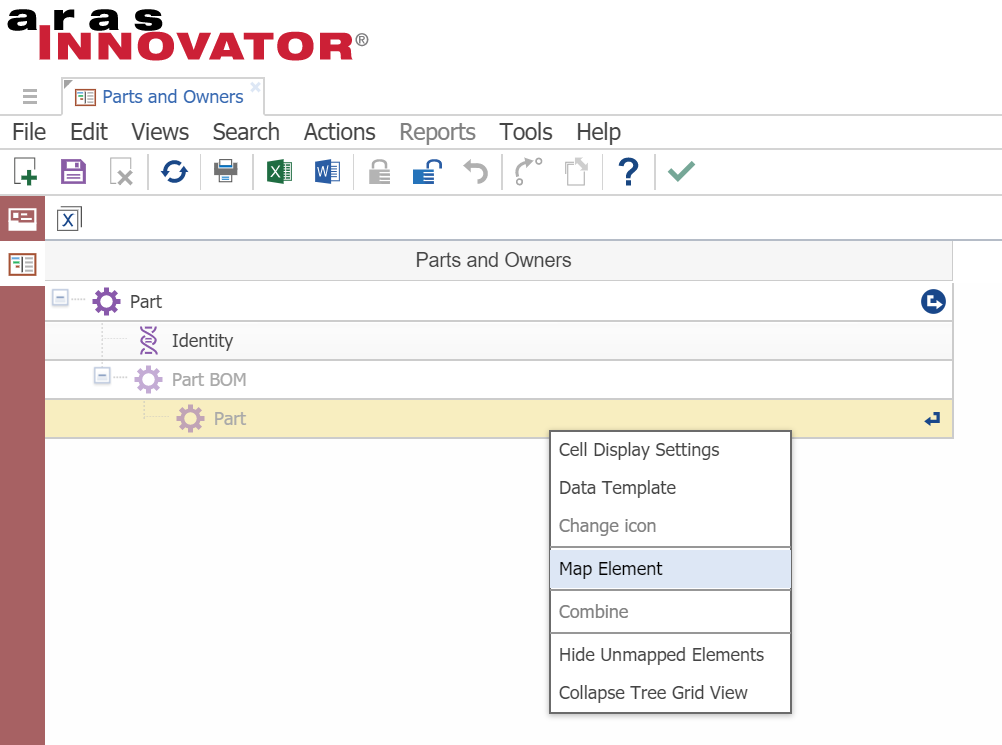

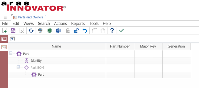

Let's save this item and click the "Show Editor" button in the side bar. You should see a simple grid with all of the cells initially blanked out. For both of the Part cells and the Identity Cell, we'll right-click on them and choose Map Element in order to add them to this grid.

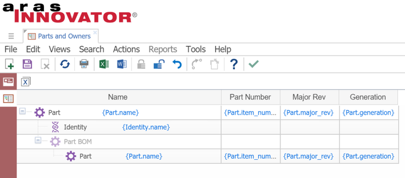

Now that all of our elements are mapped there are a few different things that we need to do. To begin with, we'll need to add 3 more columns to this grid. We can do this by right-clicking on the column header and selecting Add New Column. After doing that, we'll need to change the column names to match the properties that we're going to display in them. When finished, your grid should look something like this.
The last step we'll need to configure is what data is going to be displayed in each cell. To do this, we'll right-click and chose Cell Display Settings. This will bring up a dialog where you can map properties into the cell templates. For each column, map the corresponding property until your grid matches the one below.

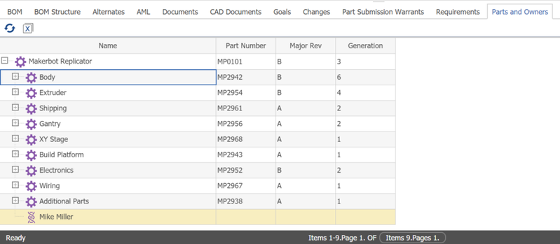

Now let's go to one of our assemblies and see the finished product!
We can see that our TGV relationship has been automatically added to Part and displays all of the information that we expect with no extra code required!
