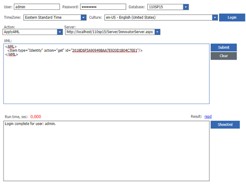

Nash
Nash is a lightweight application available in every instance of Aras Innovator which lets you run AML queries directly against your server. You can access Nash by appending `Clientscriptsnash.aspx` to the end of the URL you typically use to access your Aras Innovator instance (e.g. http://localhost/InnovatorServer/Client/scripts/nash.aspx). The Aras Homepage community project also features a handy link to access Nash on your instances.

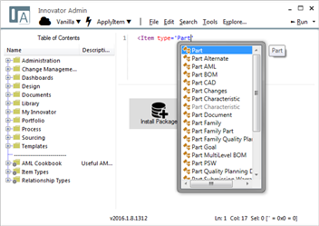

InnovatorAdmin
As an alternative to Nash, you can also check out InnovatorAdmin, an extremely useful tool written by a member of the open Aras community. In addition to some other helpful features, InnovatorAdmin lets you run AML queries just like the built-in Nash application does. InnovatorAdmin also features IntelliSense to make writing your AML queries even easier.

As a simple example, let's try querying for the Administrators Identity by passing in the ID.
<AML>
  <Item type="Identity" action="get" id="2618D6F5A90949BAA7E920D1B04C7EE1"/>
</AML>
Note: If you're testing this AML through Nash, you must wrap your entire query inside of an <AML/> tag like the example above.
