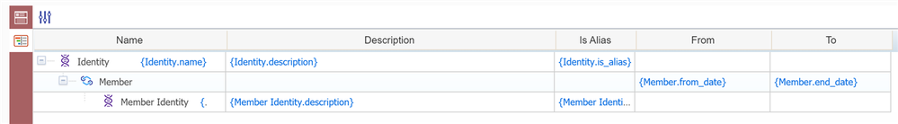

The Tree Grid View is also configured very simply. We've mapped each element into our tree and have added a few columns to store all of the property information that our Query Definition is retrieving.
Note that the middle element for the Member relationship looks a little awkward. When we actually view this TGV, the first three cells are always going to be blank. However, we still want to display the data for the Start Date and End Date to our users. Can we configure our TGV to display this data so that we don't end up with those blank cells?
Inside of the TGV editor, we can combine two different rows in order to display data from each element of our query in a single row. This can be extremely handy for displaying data from both a relationship and a related item together. For example, a query on the Part BOM could display the quantity from the Part BOM relationship inline with the actual related Part data. In our example, we can display the From Date and End Date properties on the same line as our Member Identity.
After configuring your newly combined row, your new TGV should end up looking something like the screenshot below. As an additional note, you will only be able to combine rows that are adjacent to each other in the grid and that share a parent-child link like a relationship or an item property.
The icon of our combined row has now been replaced with a default. This is because the Tree Grid doesn't know if it should use the icon from the relationship or from the related item. Let's pick a new icon to give our users a little more information about what this data actually is.

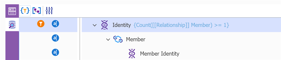

If you want to follow along, you can configure your Query Definition like the screenshot below.
The context ItemType is Identity, and we've simply added the Member relationship to the query. We've mapped a few properties like Name, Description, and Item ID, and we've added a simple condition to the top-level so that only Identities that actually have Member relationships are returned.

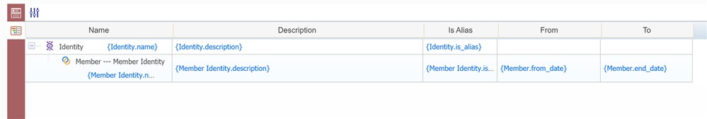

Combining Rows
- Select both cells that you want to combine (Ctrl+Click)
- Right-click -> Combine
- A dialog will prompt you that all of the existing cell configuration is going to be erased. Click OK
- Configure the cells to display the appropriate property data
- Note that when you are configuring the cell mappings, you are now offered the options to select property data from both the related item and the relationship
- Right-click -> Change Icon
- In the Image Browser, switch to the Details View so you can see the names of the icons
- Scroll down and pick RelationshipType.svg

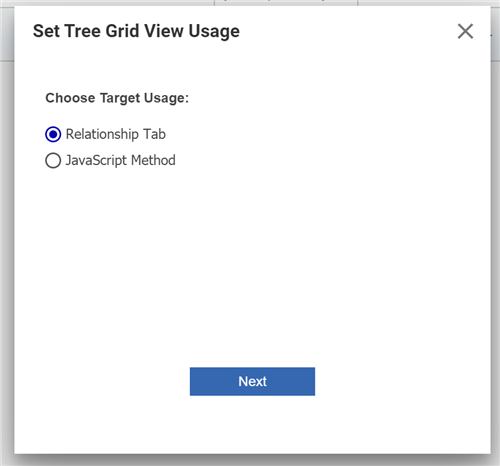

If you've followed along with your basics blog post, you've clicked through this screen while enabling your TGV.
Usually, TGVs are enabled to be visible through a relationship tab when viewing an item. When viewed this way, Tree Grids filter the results that you see based on which item you have opened. For example, the standard Mutlilevel BOM TGV will only display the Part BOM structure of the Part you currently have opened.
The second option instead allows you to set up a TGV to be opened when a user runs an action. This option is best used for report-type views that either will be based on all of the items in your database and will not be filtered by a single context item. In this case, it's perfect for our Identity Membership TGV.
Configuration
After selecting JavaScript Method and clicking next, a tab for a new Method will be opened with some auto-generated code that can open our TGV. We could customize this method to do things like add a starting condition, but for our purposes, we just want to display all of the data our query returns as-is. We can simply click Done to save this Method. Now it's just a matter of adding an action to let the user call this Method.

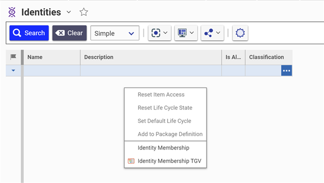

Once that's all configured, you can open up a new Identity search grid and right-click anywhere. You should see your new option visible in the context menu.

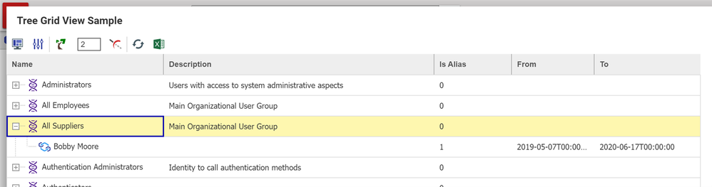

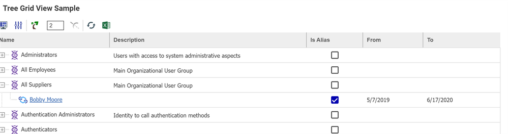

For good measure, let's also test this action just to make sure that everything is configured properly.
It's coming up as expected, and all of the data is there. The grid looks a little flat though. Our boolean value for Is Alias is displaying a 1 instead of a checkbox, and the date is in a really long, unfriendly format. Let's see what we can do to make this easier for our users.

With all of these options configured, we can take another look at our TGV to see just how much it's improved.
The grid looks a lot cleaner, and there's now even a handy link that will let our users open up the child Identities in a new tab.
