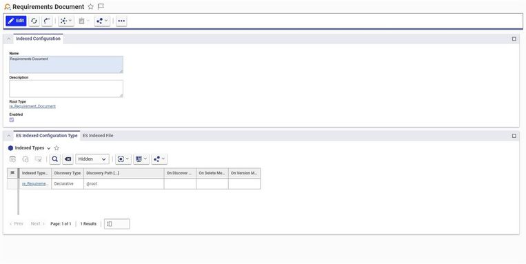

We will begin our setup by creating a new Indexed Configuration:
  1. Open up the TOC > Administration > Enterprise Search > Indexed Configurations.
  2. Create a new Indexed Configuration, the name will be Requirements Document and the Root Type is re_Requirement_Document.
  3. Next, we will need to add a relationship containing the Indexed Type. This is where we will configure the properties accordingly.
  4. In the relationship of our Indexed Configuration, ES Indexed Configuration Type, select the new button .
  5. The Indexed Type will be re_Requirement_Document, the discovery type is Declarative, and the discovery path is @root.

  6. Your final configured Indexed Configuration will look like this:

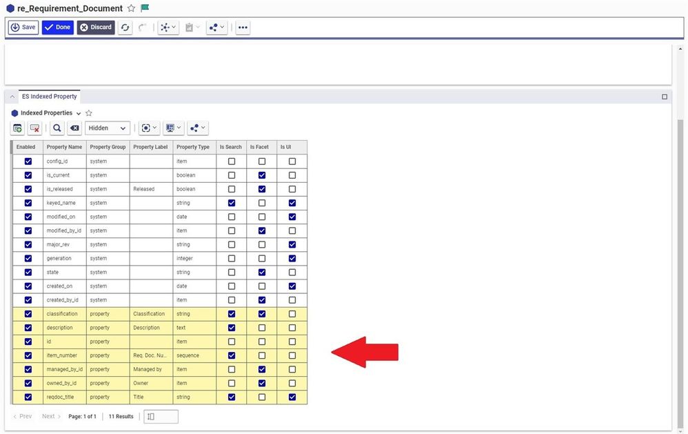

Right click on the re_Requirement_Document Indexed Type and select open. We will want to add some additional properties to make our new ItemType more searchable as well, so go ahead and add the following:
Each of these properties will be set according to three parameters:
  • Is Facet: Properties that can be filtered on the left panel of results.
  • Is Search: Properties that are searched when user fills in keywords in the search box.
  • Is UI: Properties that are displayed in the search results as additional information.

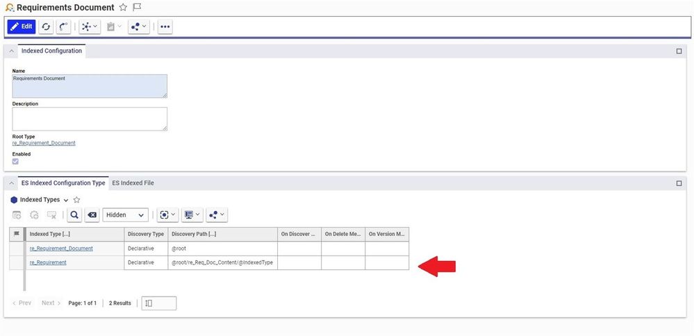

Going back to our Indexed Configuration we will set the next Indexed Type as one of the relationships of Requirements Documents to re_Requirement (the Requirements ItemType). Add the Discovery Type as Declarative and the Discovery path to "@root/re_Req_Doc_Content/@IndexedType". Should look like this:

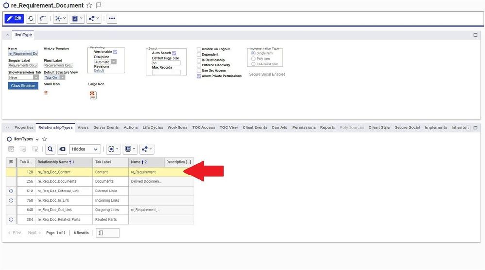

We can determine what the RelationshipType is (re_Req_Doc_Content) by looking up the root ItemType, in our case, for the Content relationship item.
  1. Open up TOC > Administration > ItemTypes and search for/open the re_Requirement_Document.
  2. Go to the RelationshipTypes tab and we will see that Content is tied to the re_Requirement ItemType by re_Req_Doc_Content.

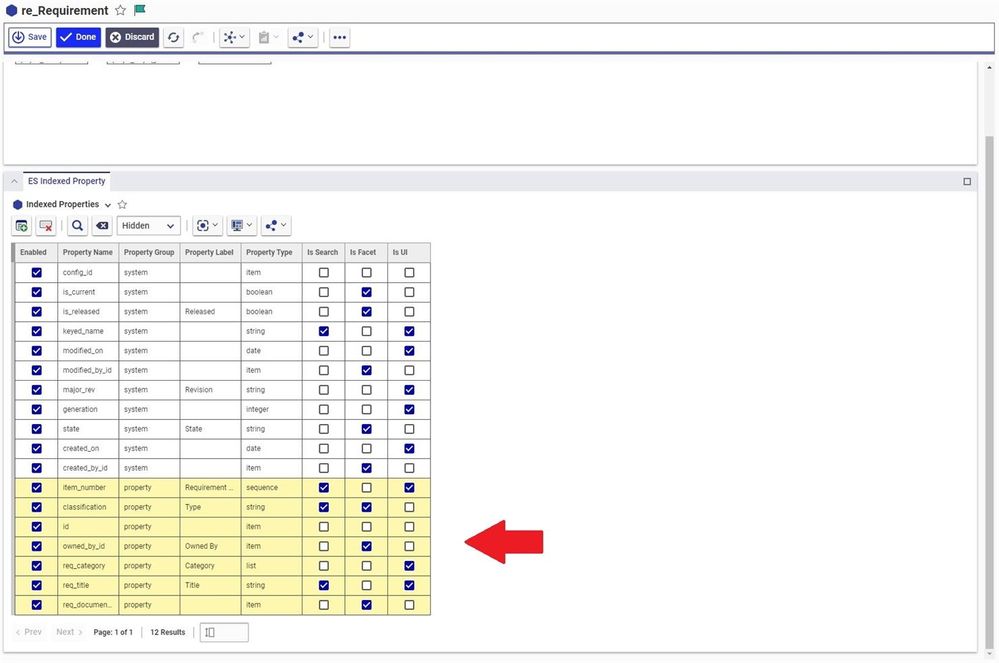

Right click on the re_Requirement Indexed Type from our Indexed Configuration to open it up. Let's go ahead and set the following additional properties:
