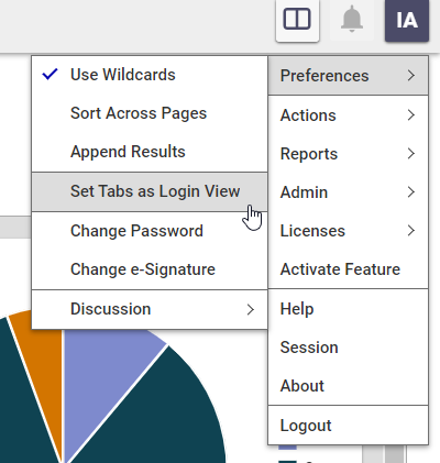

Login Views
When you load Aras Innovator, you’re prompted by a list of all your ItemTypes in a grid. While this is a great jumping-off point, you can further customize your starting page(s) with ease. All you need to do is load the tabs you utilize most often and then go to the User Menu in the top right > Preferences > Set tabs as Login View:
This function pairs really well with our new Dashboard functionality, allowing you to log in and see live views of your data.

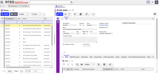

Split-Screen
In recent versions of Aras Innovator, the ability to split your main screen in half has been a game changer for working across multiple items at once. In the top right corner, to the left of the notification bell, you can see the split-screen button. Clicking this button will move all of your current tabs to the left, while any new tabs that you open will be opened on the right. You can change how much of the screen each tab takes up, allowing you to customize your workspace for your own needs better.
