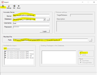

  • Hi
    Can you confirm the type option selected in your import tool. Try merge option if you have used ignore
    Thank You
    Gopikrishnan R
  • Hi Gopikrishnan, thank you for your reply.  I don't see the option you've screenshotted in the update tool for Innovator 12.  May I ask where/how you brought up this menu?
  • Hi
    Try manually importing the module.
    Open ARAS Update tool
    Navigate to required Package to be installed (In this case, ARAS Quality Management System)
    Select version and click download instead of Install
    Navigate to downloaded folder (mostly C:\ProgramData\Aras\ArasUpdate\QMS\12.0.1171\PackageImportExportUtilities\Import)
    Run import.exe
    Fill the details as below (select correct import.mf file path)
    Click Import
    Let me know if you are still facing the issue.
    Thank You
    Gopikrishnan R

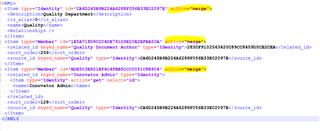

  • Hi Keith
    From your screenshot, I can understand QMS is partially installed in system. Follow below steps and let me know how it behaves
    Navigate to downloaded folder (mostly C:\ProgramData\Aras\ArasUpdate\QMS\12.0.1171\Imports\QMS\Import\QMS_QS\Identity)
    Open Quality.xml in notepad++
    Change action="merge" from action="add"
    Save and Close File
    Follow the same manual install steps (follow the steps in my previous reply)
    Thank You
    Gopikrishnan R
  • Hi Gopikrishnan,
    Thanks for your rapid reply.  I updated the file and changed all instances of add to merge, and am now getting a different error message.
    This seems to be failing on UPDATE rather than INSERT, so at least it's actually attempting to merge it this time. Does this indicate anything to you?  Might you have any further suggestions about what to try next?  Many thanks for all your help!!

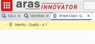

  • I'll do that (again). This seems particularly odd since I'm using a fresh install of the latest release of Innovator and it's the official sample database that I'm trying to update -- this is the definition of plain vanilla.
    I'd love to know what tables these database errors are referring to since it seems these errors might be easily resolved by deleting the record(s) that are causing the constraint violation. Any suggestions there?
  • You can navigate to Administrators --> Identity --> Search for Quality and try deleting it in UI
