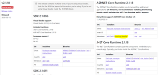

  • Thanks that worked... So, I assume that Aras really need both 32/64 bits .core installed to work. Maybe the documentation would bit one bit clearer and maybe have hyperlink to the actual needed file from microsoft :). Thanks again!
