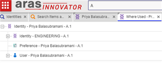

    But as a User.. I see only the below.
    I would like to know, from where I can see as an User that I am belonging to Engineering of ACME.
