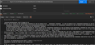

same here , I have a problem with the returned file encoding content
example :
original content : ©1'÷õ"å
returned content : �1'��"�
Even via postman I got the same problem with content-encoding
