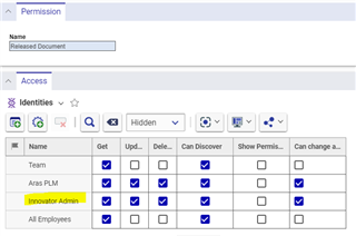

  • I have checked the permission for In Change Document item type in ARAS instance and only members of ARAS PLM role has access to edit it.
    Step 1: Navigate to Administration --> Permissions --> Search and open Released Document permission
    Step 2: Lock and add Innovator Admin user under Access tab
    Step 3: Save and Unlock Permission
    Step 4: Relogin to AML studio or Nash as admin and run the query
