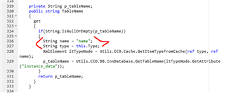

Am using a C# Method which is used to fetch the related parts of a CAD. On Syntax check i get an Obsolete method warning as shown below,
Line number 332, Warning Number: CS0618, 'Aras.Server.Core.ICachePublicAPI.GetItemTypeFromCache(ref string, ref string)' is obsolete: 'Obsolete starting from 9.3. Do not use in server core.'
But this method was working fine before.
Due to this warning the method is not working as expected. Am very new to PLM Aaras programming. I couldn't understand what is happening and how to resolve. Is there any method to replace the Obselete method or how? Any quick response would be more appreciated.

    Try using Utils.CCO.Cache.GetItemTypeFromCache(ref string, ref string) and let me know if it works
  • Hi Gopi
    Thanks for your quick response.
    Actually the error is thrown when I put a break point in the method and check for syntax. Else there is no such warning and the method executes without throwing any errors.
    And I pass string only. please ref the image below,
    Thanks.
