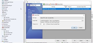

we have 12.0 SP9 + SW EPDM Connector R04
we have a custom pdf generator and would like to connect it to Aras.
Initial idea was to create a submit task in PDM Administration and send to it custom generated pdf but it looks like we have problem with that.
(for some reason system do not see necessary files)
maybe somebody have had such experience or any idea is also also welcome.

    You can upload pdf with standard IOM api or rest. Do you have programmed the shown tool by yourself? Are you already able to generate the pdf itself? The upload it self should be a big deal, maybe it´s just a permission problem?
