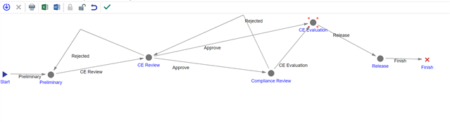

Hello Guys,
Can you please suggest me ?  I want to Complete Activity CE Review on Condition Basis(On Work Item Part Property(Critical Value)Value  NO ,Yes).
(1).If  I select Approve on CE Review  with critical Value is Yes . Then Next Activity should be Compliance Review.
(2).If  I select Approve on CE Review  with critical Value is NO . Then Next Activity should be CE Evaluation
Please suggest me . How can I achieve  it ?

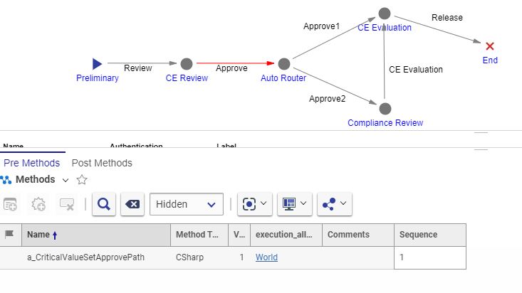

  • Hi Ashok
    This can be achieved by adding one more automatic activity after CE Review and before CE Evaluation and Compliance Review
    If you have any question on the modifications to be done in Workflow please refer my blog page
    https://arastutorials.blogspot.com/2021/06/decidevotingpath.html
    Steps to be followed are :

    Step 2: Add this method in Pre Activity of Approve Path (Activity Highlighted below)

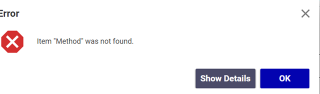

  • Hello Gopikrishnan,
    Thank you for your suggestion.
    I am getting error message at line number 3.
    /*ND Check Compliance Critical for Input YES OR NO On Part Item*/
    1. Innovator inn=this.getInnovator();
    2. string activityId = this.getID();
    3.Item controlledItem = this.apply("Get Controlled Item");
    return inn.newError("Name "+this.getType());
     Any suggestion for Error ?
    Thank in Advance.
  • Have you created method given in step 3 ?
    Step 3: (Skip if this method already exist) Create below server method (VB) in ARAS Instance (Method Name should be Get Controlled Item)
