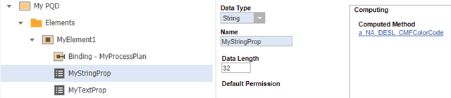

I'm working through the CMF guide, and attempting to implement the task in 4.1.9 (Set the text color for a given zone) for a real world use case.
In my Innovator instance, I have a CMF Item Type called MyPQD, with two properties -- MyStringProp, and MyTextProp. (per an earlier example in the guide)
I'm using the following code, but not having any luck getting the color to change. Any idea what I'm doing wrong here:
