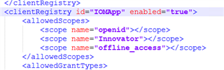

    Maybe you have to modify the ...\OAuthServer\OAuth.config. It conifgures the grand types. IOMApp doesn´t contain impersonate right now:
    You could try to add <grantType name="impersonate"></grantType> . But I am really just guessing.
  • Yes i have had no luck as of yet with support. I dont think grant type of impersonation is the way to go afaik it mostly for server to server communication.
