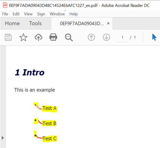

In ARAS technical documentation using "Standard" schema and Standard Style settings, I created document with list-item and please see below.

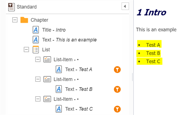

In editor mode, it looks fine and the text and bullet points are aligned and they are in same line.
However, when I publish it to PDF, I could see the text has dropped down and it is not in same line with bullet list.
Wondering if this is a bug in ARAS (or) is there a solution for this?
Please clarify.
Editor mode:
PDF Published document:

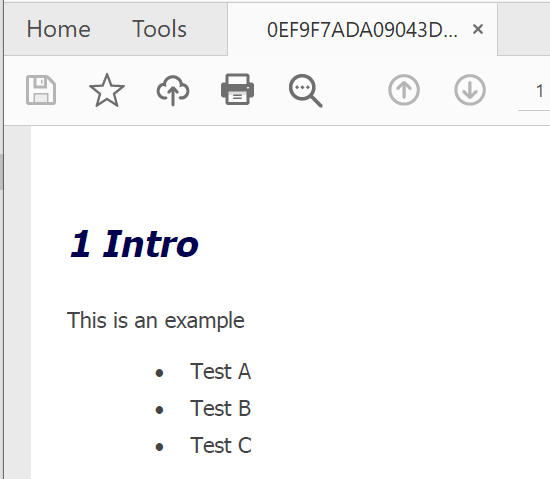

    An update. This is a bug in ARAS Standard Style Settings CSS code and I am able to fix this with below code
    .List, .List-Item, .List-Item > .Text {
    padding-top: 1px;
    padding-bottom: 0px;
    margin-top: 0px;
    margin-bottom: 0px;
