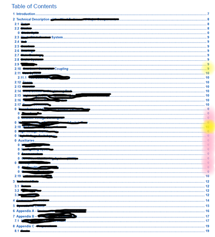

I have created maxcase technical document in ARAS Technical documentation module and have applied series of filter conditions.
Once I publish my document to PDF for a set of required filter conditions; and then open PDF, I see in Table of Contents page, along with filtered chapters and sections; there also appears these non-filtered chapters and sections with page number as 0 and chapter/section number as 0.
I don't want these (unwanted chapters/sections which are filtered out based on my applied filter conditions) to appear in table of contents page with page number as 0 and chapter/section number as 0.
Please help me how to get rid of this.
Attached below is snapshot on how it looks like in published PDF (pink highlighted ones with 0 are not required to have in TOC)
