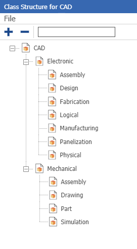

    For example, if we look at the CAD ItemType, it has a default classification structure of:

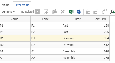

    I was able to reproduce the behavior you're seeing by creating a filter list against the classification property with filtered values like the image below.
    With these filters, my filtered list was not being populated with any values even when I was viewing a CAD with a classification of Part or Drawing. The issue here is the value of the classification field in the database for these CAD items is actually Mechanical/Part, Mechanical/Drawing, or Mechanical/Assembly.

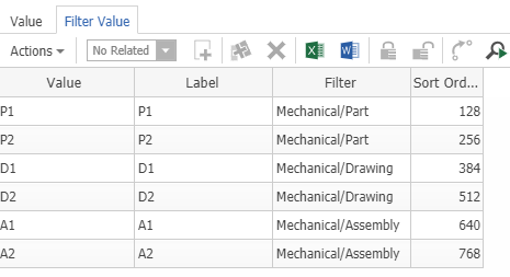

    If you update our filter list to include this fully-qualified classification like the updated image below, you should notice that your list is populated with the values you expect.
