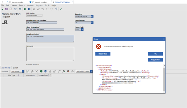

I'm having an issue and I'm hoping the community can help me solve it!  I'm running into a an issue when creating a relationship on an ItemType with a workflow. I'm unable to create/save my new ItemType while getting an arbitrary  error of "ItemIsLockedException".
When I remove the workflow from my new ItemType I'm able to create and save an object no problem. When I add the workflow back on, I can fill out my form, but as soon as I try to save my item it gives me the lock error.

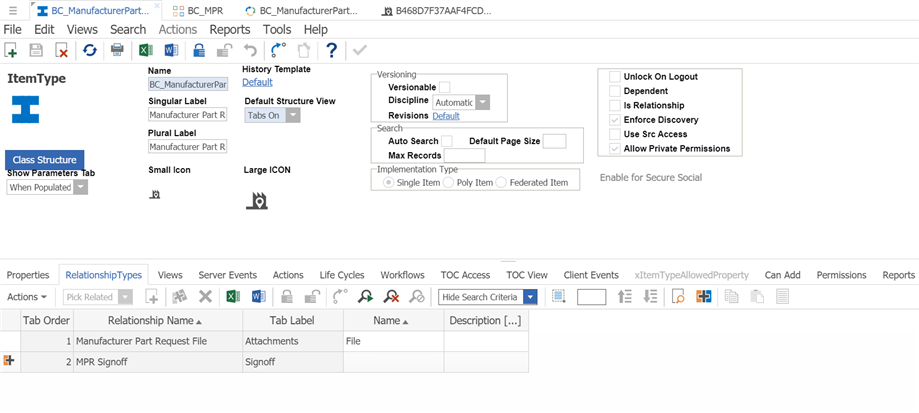

    4. Is your Relationship ItemType the same as your parent ItemType, or do you link a different ItemType?

    3. Do you just get the error message when adding a relationship, or also in other scenarios? The error message happens when I try and create a new manufacturing part request. It allows me to fill out the form, although once I try and save my request, It spits out the "ItemIsLockedException" error.
    4. Is your Relationship ItemType the same as your parent ItemType, or do you link a different ItemType? See Screenshot
  • Here's a screenshot of my error
