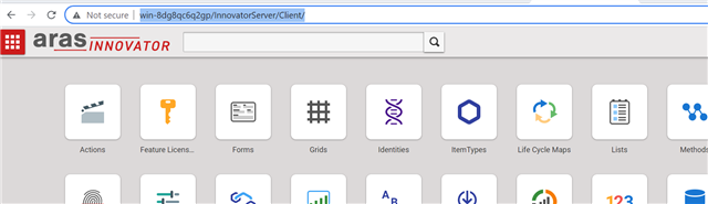

    I am try to access  URL(http://win-8dg8qc6q2gp/InnovatorServer/Server/) getting error.
    I am to login with url(http://win-8dg8qc6q2gp/InnovatorServer/Client/) able to lgin
  • オフライン in reply to Ashok.Yadav
    Hi Ashok
    Check with your server administrator.
    From the image that you have attached it is clear that the URL (http://win-8dg8qc6q2gp/InnovatorServer/Server/ ) is not correct and the request is not validated.
