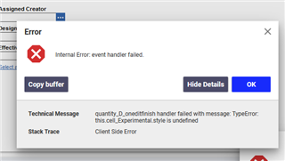

in the vanilla version of Innovator12 I have a simple method that change the bgcolor on a specific properties if the value can be "wrong"
the methos is a clientSide method very simple:
//change color bg
var cell = g
With the newer version (tried in sp9 and sp4) the method returns an error:
Seem the method tried to modify the property adding a suffix "_D"
is something change or is a bug ?
I tried other event (eg onChangeCell) but nothing change
the method is triggered in a grid.
