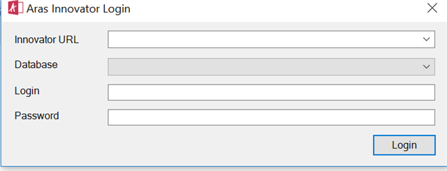

The connector is well installed, when trying to create new aras document from Word, a windows is opened and I have to fill the Database, username and password as in the image below :
When I click on Login, I get the error.

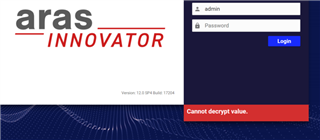

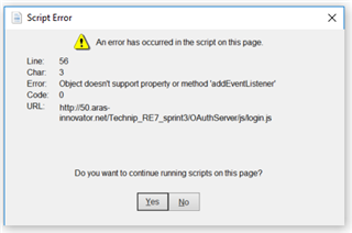

I installed the version 12 and I have no longer the previous message error. But, still can't connect to Aras, I am getting now the following errors :
And when I click Yes and I have the following message : Cannot decrypt value

In the past, I've most often seen that error crop up when someone is using an old browser. IE8 and previous doesn't have an addEventListener. You might also be running in some kind of compatibility mode, making your browser think you're in IE8. What browser is it opening in?
(I've also seen it as an error in Javascript methods, but I wouldn't expect you to have any custom methods in a relatively fresh install.)
