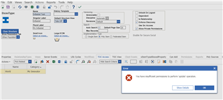

I have tried to assign all the items to Administrators from the TOC Access except My Inbasket which is not possible from the TOC Access (see screenshot below)
As you can see from the screenshot below, i need to keep just Home and remove My Innovator from the TOC Pane.

  • Are you are tying with root login ? If so, can you try deleting the TOC access instead of updating it. (World and My Innovator) and add (Administrators and My Innovator)

  • This is not specific to My Inbasket. The error indicates that the ARAS user with which you tried to update the Item, doesn't have permission to update this Item. You can check permissions for this Item and perform the operation with user who has permission. Alternatively you can grant permission for yourself temporarily and then revoke. Here is how you can check the permission
    Here is default Item Type permission
