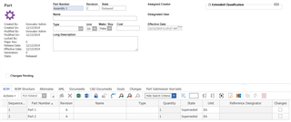

- I see that on promoting express ECO to Draft Changes that a new part is created and the old part is marked as superseded. However, the Part is not replaced in the BOM.
- although it says "Superseded" there is no obvious way to view this on the BOM or what part superseded it.

- I see that on promoting express ECO to Draft Changes that the old part is marked as superseded. However, the Part is not replaced in the BOM.
- On the assembly part I see that it says "Superseded" there is no obvious way to view the superseded part except by navigating through ECO.
The pictures show Assembly 1 contains Part 1 that I renumbered and Part 2 that is superseded.
