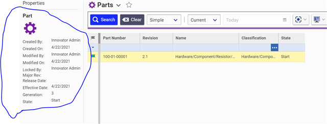

Hello Guys,
I want to add some custom properties under the marked area in below image.
please help me.
Thank you

you can customize nearly everything in Innovator. But sometimes not in the database directly.
This side pane can be customized in the codetree. I far as I remember, these two files are involved:
..\Client\javascript\ui_methodsEx.js
..\Client\xml\ui_resources.xml
Just look for entries called ItemInfo or item_info and add your own elements the same way as the existing ones.
Write a test case for this codetree change when you are an subscriber. This is a typical codetree change that might be overwritten by the update team. So ensure to tell them that you have changed these files.
Thank you Jayrajvh it's working
