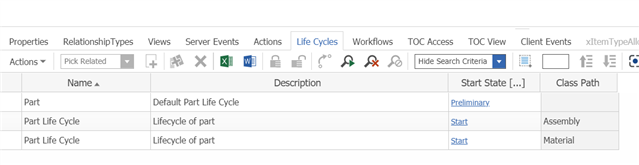

I have a Part Item type with the following Configuration for its Lifecycle:
As seen , I want the Assembly and Material classification to have a different life cycle from the rest of the Parts.

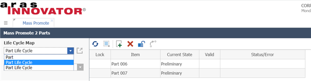

However when I try to mass Promote the items of either of the classification I am unable to do so.
In the LC Map drop down If I select "Part" the mass promote functionality is working as expected.
However if i select the second Lifecycle the "Target" field remains disabled.
Has any one else faced the above issue, Am I missing any configuration , if not is there any work around for the same.
