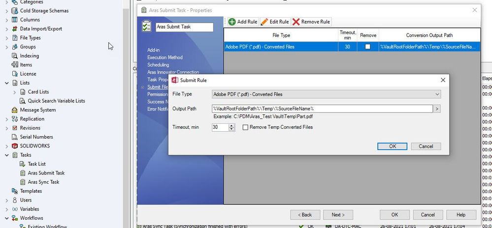

we have a custom pdf generator and would like to connect it to Aras.
Initial idea was to create a submit task in PDM Administration and send to it custom generated pdf but it looks like we have problem with that.
(for some reason system do not see necessary files)
maybe somebody have had such experience or any idea is also also welcome.

      on a screenshot you can see Submit task in SolidWorks PDM.
      Indeed we have a custom tool for pdf creation from our drawings. that tool have already pretty much other functions.
      At this moment we would like to use it to switch jpeg viewable files to those pdfs.
      It looks like using Aras Submit Task is good enough for that.
      What kind of permissions and where should we check to be able to do what  we want, Angela, how do you think?
      Permissions inside that task itself?
