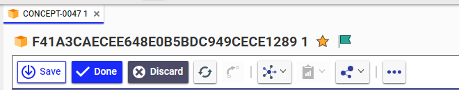

GUID showing up in keyed name on change of an item while in edit mode.
After creating an item, if I open the item back up and make a change to it, the keyed name changes from its original name to the GUID. In this case the original keyed name was 'Concept-0047 1' but after making a change it switched to the guid of the item. If I save the item it will go back to the original name of 'Concept-0047 1' so it is only an issue if the user is editing the item. If there is a solution to this please let me know.
  • What Innovator version are you using? I remember seeing this behavior in earlier Innovator 12 versions, but I think Aras have fixed it.
